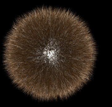

which parameter is to make the fur render more Oilly?
hi, i would like to know how to make the hair fur in houdini mantra render can make the hair look more oilly?
i am using Add Fur tools to the human model hair, but i don't know how to make the hair looks more oilly or shinning.
can anyone tell me where can i agust this ? i guess should not be specular right ?
thanks
cheers
It's definitely specular. Play with the roughness. You can also try rendering out the specular export from the shader as an extra image plane and composite it on top of the diffuse. You could even have multiple specular passes.
Edit: The more fur you have, the easier it will be to see the specularity. Try increasing the amount.
