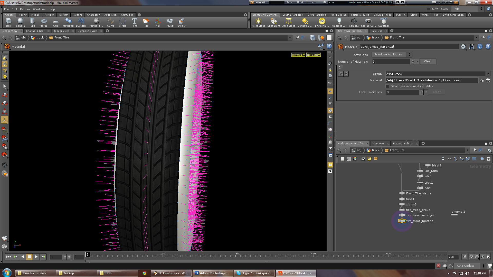

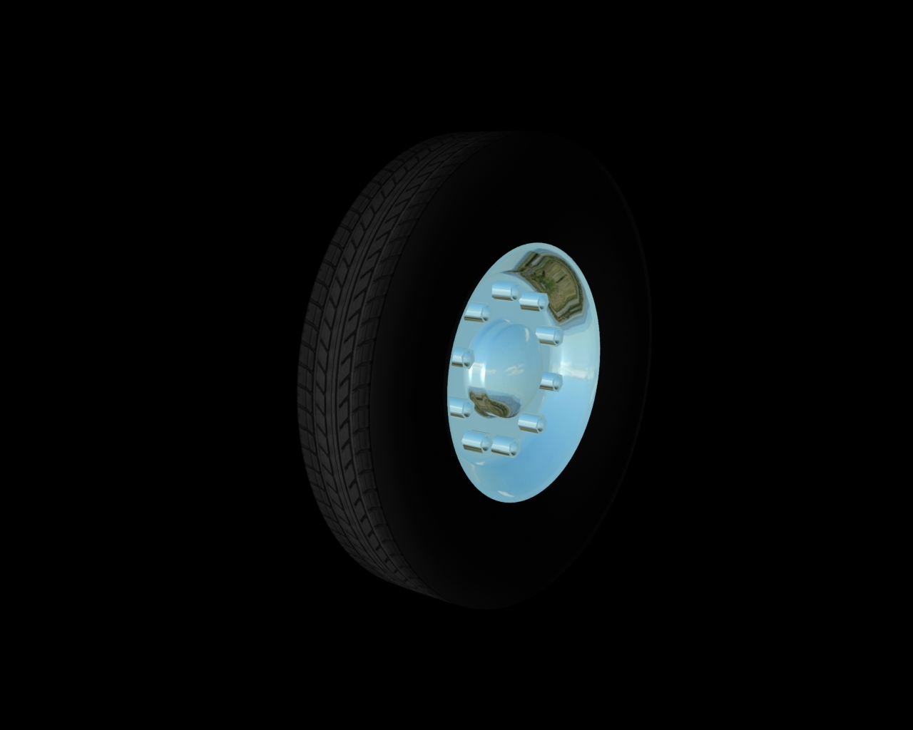

Tannins Posted November 5, 2010 Share Posted November 5, 2010 I've got a tire that I've applied a group for the tire treads and then a uv project (to the tire treads group) and a material to that. I seem to get a great shot in the viewport, but in the render I don't get anything? Any suggestions? Quote Link to comment Share on other sites More sharing options...
Macha Posted November 5, 2010 Share Posted November 5, 2010 You don't have a material assigned to it a level higher up? The texture map is assigned in the material shader as well? Quote Link to comment Share on other sites More sharing options...
Tannins Posted November 5, 2010 Author Share Posted November 5, 2010 You don't have a material assigned to it a level higher up? The texture map is assigned in the material shader as well? Yeah the texture is assigned in the shader it is really strange. I don't have the material assigned to it at a higher level because the whole file is quite large so I tried to organize it in subnetworks. I tried assigning a Material at a higher level and there was no difference. I tried using a shader node instead of a material node and it works fine (except I get a little warning on the node saying that "this SOP is depricated in favour of the material SOP")! Quote Link to comment Share on other sites More sharing options...
Tannins Posted November 5, 2010 Author Share Posted November 5, 2010 Yeah the texture is assigned in the shader it is really strange. I don't have the material assigned to it at a higher level because the whole file is quite large so I tried to organize it in subnetworks. I tried assigning a Material at a higher level and there was no difference. I tried using a shader node instead of a material node and it works fine (except I get a little warning on the node saying that "this SOP is depricated in favour of the material SOP")! nevermind - figured it out... for some reason the mantra node had been set to a previous version (8). prolly didn't recognize the material shader. That was driving me nuts. Quote Link to comment Share on other sites More sharing options...
