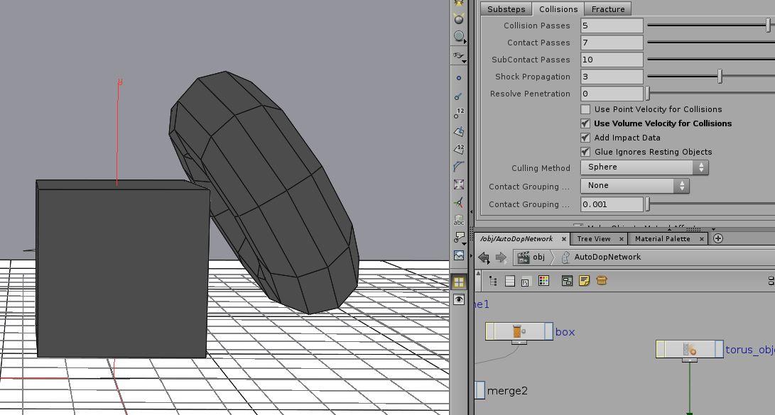

Macha Posted March 8, 2011 Share Posted March 8, 2011 (edited) My fresh morning-mind thinks your problem lies here. But it is kind of odd that we need to change it. Unless I oversee something even more obvious as well. Edited March 8, 2011 by Macha Quote Link to comment Share on other sites More sharing options...

Macha Posted March 8, 2011 Share Posted March 8, 2011 Really? If I tick the Point Velocity or the Volume Velocity for Collision it works. Quote Link to comment Share on other sites More sharing options...
Macha Posted March 8, 2011 Share Posted March 8, 2011 Time for bed Javier. And drink a glass of warm spiced wine. nowworking.hipnc Quote Link to comment Share on other sites More sharing options...
Netvudu Posted March 8, 2011 Author Share Posted March 8, 2011 oh my, thanks Macha. I was going mad. Is there an explanation on why this option isn´t on by default, or why is it necessary for static objects? Quote Link to comment Share on other sites More sharing options...
