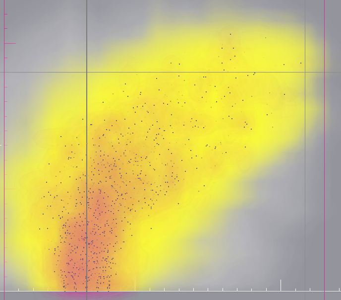

Adam Ferestad Posted May 30, 2011 Share Posted May 30, 2011 I have been trying to get a pyro simulation to source from a particle sim, but it doesn't seem to want to stick to it. I am still a real novice with pyro, so I am not really able to figure out how to get it to stick right. I need it to trial tightly to the path the particle follows through the scene. Any ideas? Quote Link to comment Share on other sites More sharing options...

Macha Posted May 30, 2011 Share Posted May 30, 2011 Hey Adam, does this help? pyropoints.hip Quote Link to comment Share on other sites More sharing options...
Macha Posted May 30, 2011 Share Posted May 30, 2011 This shows the speed a bit more clearly. Quote Link to comment Share on other sites More sharing options...
Adam Ferestad Posted May 30, 2011 Author Share Posted May 30, 2011 I will have to look at it some, but I tried to apply some of the techniques from my scene to your file and they don't seem to mesh well. I am actually using a Particle SOP rather than a POP network currently. I couldn't figure out how to do what I wanted with any of the POP nodes. I am needing the axial force on the Force SOP, which I cannot find an analog for in the POP nodes at all. I am attaching the file, though it is really rough and disorganized for the moment, so don't judge too harshly. It is just too hot right now to go through and clean it up. What I need is a good way to fill in the tornado and have it actually look like the dust/smoke is whipping around in it. There is still a lot of work that needs to be done on the system, but I was wanting to get the look right first. Any ideas? Quote Link to comment Share on other sites More sharing options...

Macha Posted May 30, 2011 Share Posted May 30, 2011 One of the problems you're probably having is that your standard pyro setup has forces that battle with the forces you input from your popnet, notably boyancy. You need to reduce those forces and/or mix/advect them with the forces of your popnet (probably v). In the example I posted above the only thing that happens is that I change the initial force when the fuel and smoke is emitted. You probably want to continuously affect those forces. To do that you could pipe in your popnet and create a field out of them and gascalculate it with the velocity of the smoke. Quote Link to comment Share on other sites More sharing options...
Macha Posted May 30, 2011 Share Posted May 30, 2011 You might not need a pyro setup in the first place. Just sops with a few volume nodes is likely to be sufficient. If you want you can make your poppet in dopa and use the nifty vortex force. Quote Link to comment Share on other sites More sharing options...
