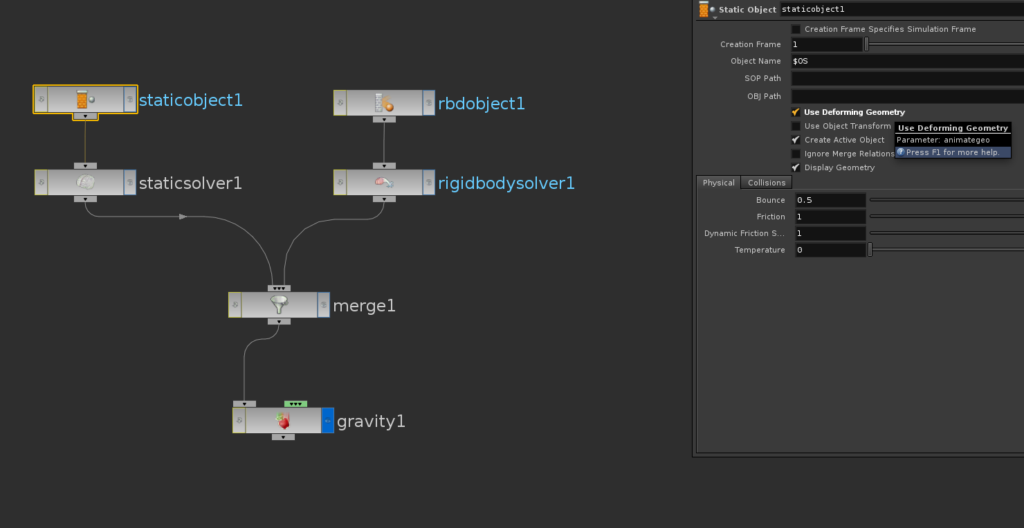

Are you using a static object plugged into a static solver?
Here's a picture that should be the very basic set-up.
The static object is your character, and the RBD is whatever you want the character to kick around. Note that the Static object is the one where you should check "use deforming geometry"
