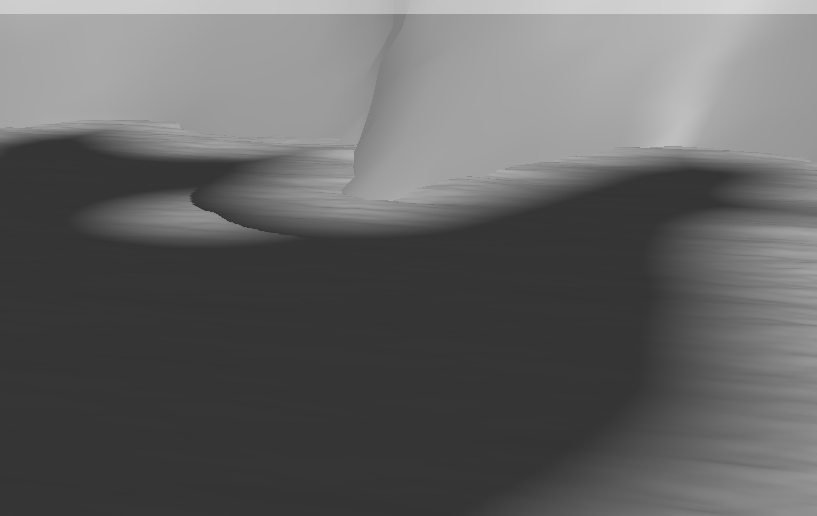

I'm need some assistance with pointclouds. I'm trying to use pointclouds as a mask to feather the displacement on my ocean near the shore. The problem I have is that my poincloud crates a mask around Origo.  I cant seem to figure out how to avoid this problem.
I also attached the hip file if anyone is interested in having a go at it.

Your search radius is too small, the point cloud open gives back a value [0,0,0] if it doesn't find a point in the search radius, hence why it doesn't work at the origin.
Just have a value different for the search radius and for the displayed radius
