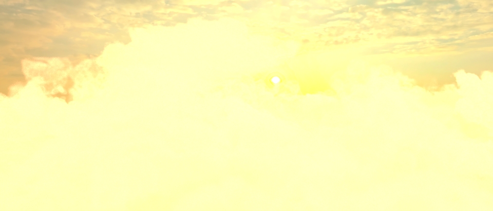

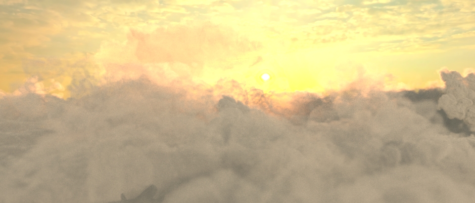

LGanc Posted July 23, 2014 Share Posted July 23, 2014 Hi there, I'm new to Houdini and I'm having trouble rendering a scene with clouds. As you can see from the attached images, the render comes out looking very different to what I get in the preview window and I have no idea why that is... If somebody could point me to what I'm doing wrong I'd very much appreciate it. Lucas. Quote Link to comment Share on other sites More sharing options...
Guest tar Posted July 23, 2014 Share Posted July 23, 2014 Try setting your manta to raytracing. That's what preview does Quote Link to comment Share on other sites More sharing options...
LGanc Posted July 23, 2014 Author Share Posted July 23, 2014 Thanks for the tip Marty. I tried it but it came out looking close to the other renders rather than the look/colors of the preview... I'll render one frame so you can see what it looks like. Quote Link to comment Share on other sites More sharing options...
Guest tar Posted July 23, 2014 Share Posted July 23, 2014 Looks like your missing shadows. Make sure to set the light shadows to raytracing. Preview defaults to ray trace shadows Quote Link to comment Share on other sites More sharing options...
LGanc Posted July 23, 2014 Author Share Posted July 23, 2014 That was it! Thanks a lot Marty. Quote Link to comment Share on other sites More sharing options...
