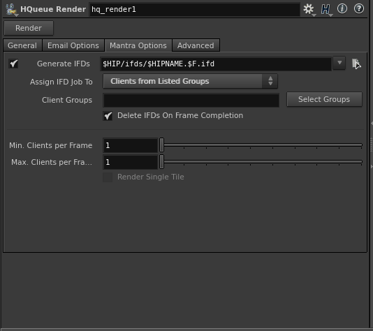

Here's an idea:
1) Create two groups on your server. One called IfdGenerators (add two Engine machines), and IfdRenderers (add the other 8 machines).
post-3767-0-65609900-1426715020_thumb.pn
2) Configure your HQ Render ROP like this gif, assigning the groups where appropriate.
post-3767-0-62865500-1426715008_thumb.gi
Does that work?

Aye Eye I.  Yes, indeed, you are correct sir.  After I wrote this post I had another look.  What threw me off is this:  In the advanced tab, if you set "assign to" to be either "listed clients" or "clients from listed group" and then hover over the word "client" or "client groups" the tooltip help window that pops up says
"The list of clients that HQueue can assign the ifd creation jobs to. ..."
You can see how that might lead me to believe that I was providing a list of clients that HQueue could assign the ifd creation jobs to.  Ugh.
This is in H14, btw.
