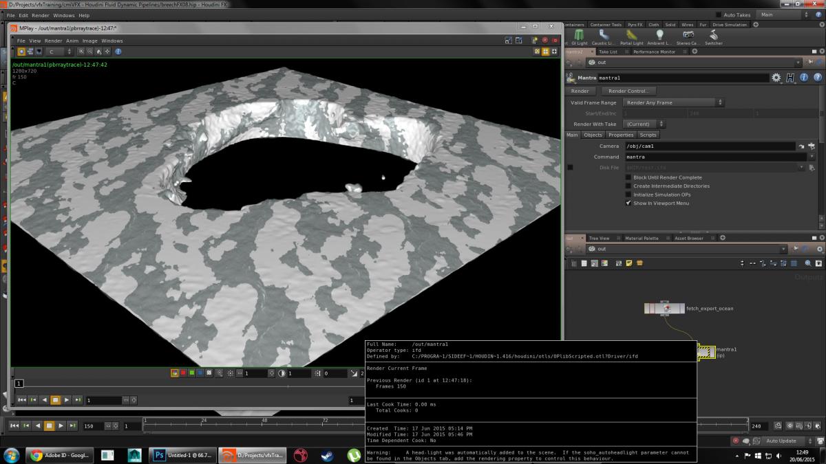

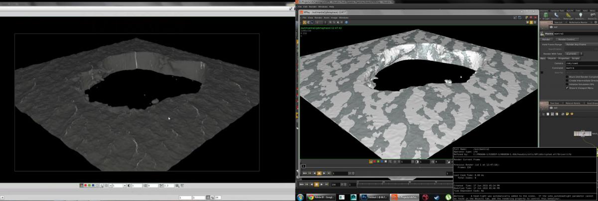

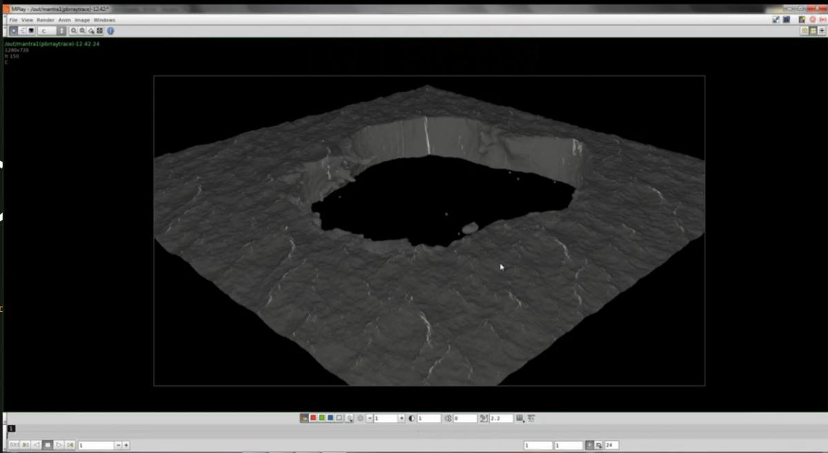

n4vdeep Posted June 21, 2015 Share Posted June 21, 2015 Hi I hope that I have posed this in the right place. I am following a tutorial on cmiVFX called Houdini Dynamic Pipeline and I am and at the end of Meshing and Displacement part of the tutorial. The problem I am having is that my render is coming out looking like and army camouflage rather than remotely ocean like. I have followed all the steps the tutor has and my nodes are set up the same way with the exact same parameters and values but still doesn't look the same as his. If anyone can help I'd be highly appreciative as I've been trying for days now to fix this by playing with different values and rewriting out the displacement maps etc but nothing i chance affects the end result. I am using Houdini 13 and so is the instructor in the videos. I have attached some images to show my problem, my render is the one on the right and the tutors is on the left, mine looks more like camouflage. Please help Many Thanks Nav Quote Link to comment Share on other sites More sharing options...
SSFX Posted June 21, 2015 Share Posted June 21, 2015 From the look of it, I would say some attributes being misused in the shader or you have two mesh overlapping each other one with the displacement and the other without. It's really hard to tell from a picture. Can you post your scene so we take a closer look at what is going on? Quote Link to comment Share on other sites More sharing options...
n4vdeep Posted June 22, 2015 Author Share Posted June 22, 2015 Hey thanks for the reply. Happy to post my scene, sorry I am new to OD FORCE. Thanks for your help in advance if you can figure this out, I've been trying for days now and cant work it out. breechFX08.hip Quote Link to comment Share on other sites More sharing options...
n4vdeep Posted June 22, 2015 Author Share Posted June 22, 2015 hey man, just went back into my scene on your suggestion that there was overlapping geo there and guess what......there was!! So this was the reason why my test render looked a mess. I had the base sim on so that was being rendered too. Man Thanks a lot. Turning it off fixed the issue. Thanks Nav Quote Link to comment Share on other sites More sharing options...
