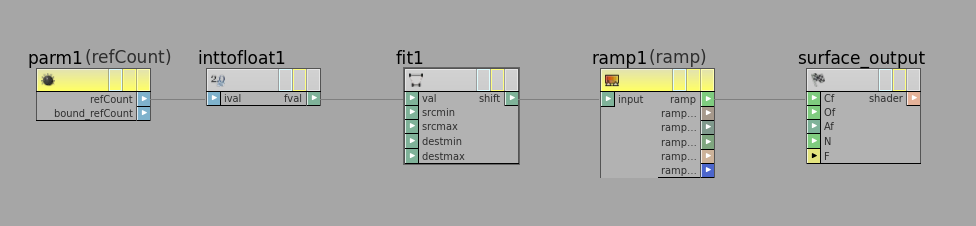

Edit: Solved, input attribute needs to be of type float to be interpreted correctly, int is not ok apparently, even if converted.
I have a bunch of points that carry a "refCount" point attribute of type integer. I wanted to create a simple flat shader that colors geometry based on this attribute. I had a vague memory of how to accomplish this and looked in the forums to confirm this. However it appears that the approach I tired doesn't work; in mantra, the points only carry the leftmost color of the ramp, i.e. the one closest to 0. I've attached a screenshot of the network as it's simpler than explaining. The fit range node takes in the expected range of "refCount" and outputs values from 0 to 1 for the Color Ramp.
I have enabled attribute visualization in the viewport and can see that Houdini picks up the "refCount" attribute just fine. What am I doing wrong in the shader?
