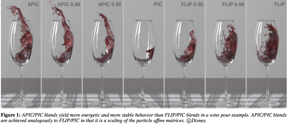

Guest tar Posted March 27, 2016 Share Posted March 27, 2016 H15 Flip has added, from the manual, "Swirly Kernel" (based on the APIC technique) for high vorticity simulations, so you should try that. No one is really testing SPH afaik. There probably are some nice research papers trying to get it's characteristics into FLIP though! Quote Link to comment Share on other sites More sharing options...
nigelgardiner Posted March 27, 2016 Author Share Posted March 27, 2016 yeah there's lots of papers, sadly it's been a long time since I've been able to read and follow math. i was using sph in blender with some success hence trying to use in houdini, perhaps I'll try to do the same with flip and see what the results look like. apart from anything flip has to be faster than sph. Quote Link to comment Share on other sites More sharing options...
Guest tar Posted March 27, 2016 Share Posted March 27, 2016 Here the link: https://disney-animation.s3.amazonaws.com/uploads/production/publication_asset/104/asset/apic-aselle-final.pdf Quote Link to comment Share on other sites More sharing options...
