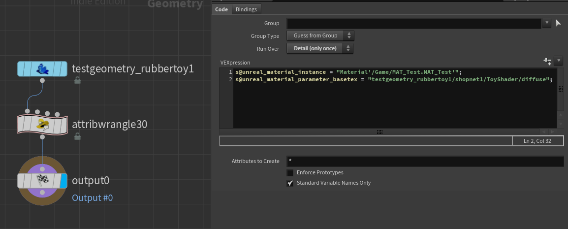

I have stripped my testing down to just using the rubber toy test geo. I am only using one wrangle that I have tried running it over primitives and detail to set the unreal_material_instance string attribute to the unreal material path, and the unreal_material_parameter_* attribute (in my case unreal_material_parameter_basetex) to the material channel of the principled shader inside the rubber toy geo (I've tried both diffuse and basecolor).

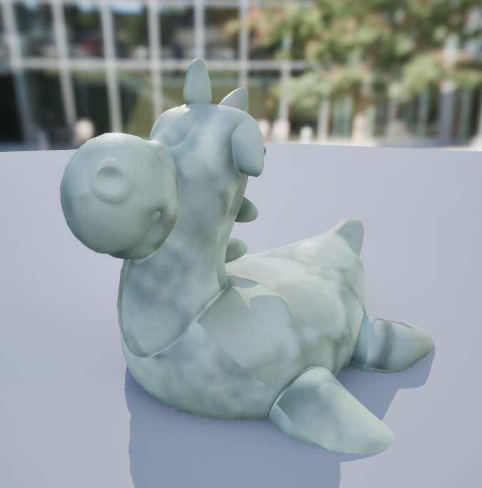

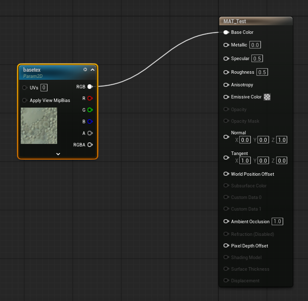

The material instance is correctly generated from the material, but nothing I have tried has successfully replaced the texture parameter on the material instance (called basetex here).
In troubleshooting, I found that if the parameter is a float and I set "f@unreal_material_parameter_floatparam = 0.5", the material instance is overridden correctly. It also works correctly if I point s@unreal_material_parameter_basetex to an existing unreal texture by copying its reference path.
The HDA exists in obj/geo1/HDA and the rubber toy geo is directly inside there (so from the squab example in the documentation I believe the path I want is testgeometry_rubbertoy1/shopnet1/ToyShader/diffuse)
