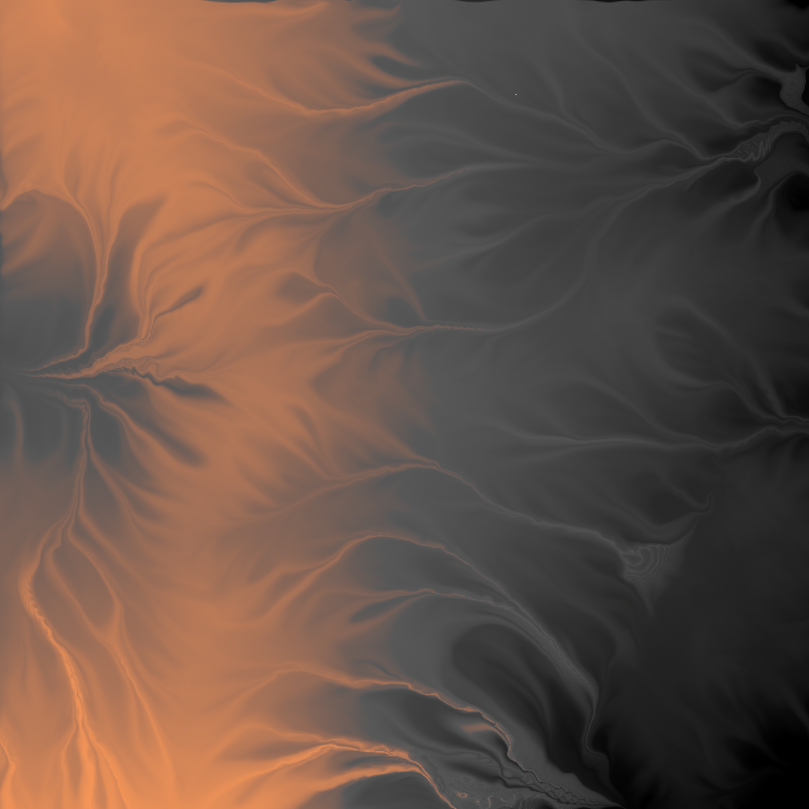

Richard Posted 5 hours ago Share Posted 5 hours ago I was playing around with this idea for fluvial texturing of terrains. You can get an idea of how I got on here. https://www.youtube.com/watch?v=3IWnBREVup0&t=13s I would say it depends on the look you are going for. As you mentioned cops flow tends towards tendrils swirls. pic02 I didnt end up putting it in the video above but what can help to soften these off is to do a distort in the flow block, if you use the same velocity you will be distorting the flow at each timestep. This ends up giving you softer transistions between areas by basically blurring in a direction at each step. I think I also added a streak blur after the distort again with the same velocity. In my case for terrains I only care about the end result, so no animated mixing, just the final texture. If you want proper mixing, where one color nicely diffuses and mixes with another color then I dont think that the current flow block does this. There is a pyro color smoke example (type pyro configure color smoke) which does some nicer mixing which might be worth a shot. Quote Link to comment Share on other sites More sharing options...

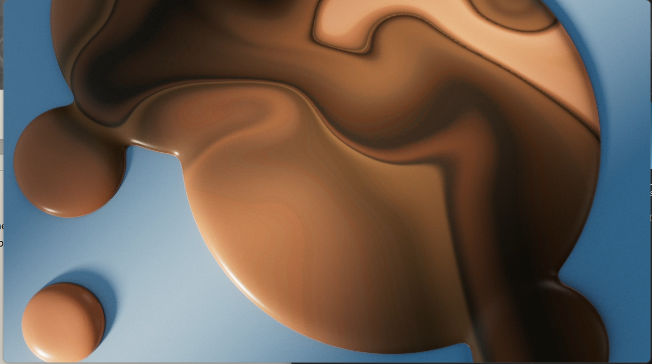

ChrisCousins Posted 2 hours ago Author Share Posted 2 hours ago Nice Richard - looks interesting, I'll try these ideas out. For me actually minimal mixing is ideal, the colours should stay nicely separated. Damping down the velocity is a good plan. At the moment I'm using a mono-rgb at the end with tight-spaced knots to give me the different shades. Not exactly what I was after, but it's looking promising. Quote Link to comment Share on other sites More sharing options...
