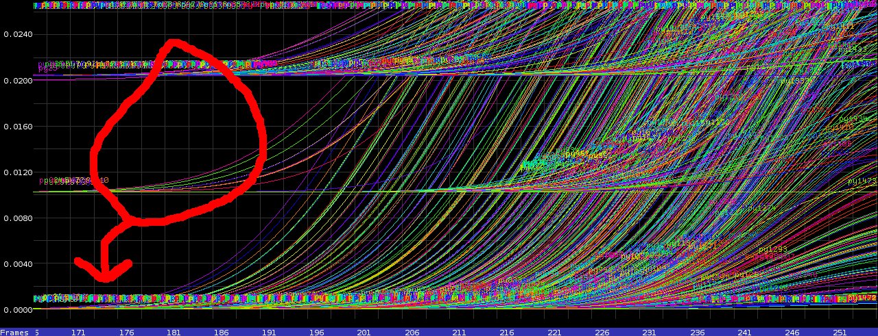

Hi,
I have some point information in chops. I'd like all the curves to start from 0. At this point they start over a range from zero to one. So i'm looking for an expression that basically sais:
if the start of the channel is more than one, subtract that value from the channel, otherwise leave 0.

Hi andrew,
Thanks for your fast reply. I made a quick image to illustrate the problem. As you can see, some curves start not on a value of zero. I'd like to shift these curves so they all have zero as their original start at their current Index (for example. Channel 40 has a start value of 0.5 at frame 23. This needs to be: start value of 0 at frame 23.
I'd normally do this with a math chop but there are many generated curves. I tried your expression but it didn't work. Filled both in but zero gives me zero for all curves and the other one made no difference at all.
Previously I made this example using a similar technique i'm trying right now. The only difference is is that the particle emission is not form a grid but a cube like shape. That makes my position channels offset a little bit (use the y direction for chops). So that's what i need to correct :)
Hope this extra info is what you need.
Cheers Coen

Ah now I see ... ok, the thing to do then is to split this operation off into two paths.
Use an expression CHOP set to
ic(0,$C,0) ... this will give the first sample through the entire channel range.
Then use this value to subtract from your channels; should give the correct offset. You could probably put it all in one expression CHOP like this:
$V - ic(0,$C,0)

Hi andrew,
That works great! I'll test tonight if it does what i expect it to do :rolleyes:
Just one question:
with your expression you're saying: calculate the distance of the incoming channel to zero and substract this from it's total value. But why exactly does "ic(0,$C,0)" give you the first sample of the entire range? Checked the help of the expression chop but didn't make things any more clear
But again... Thanks!
edit: sorry, my fault. Read over it: It checks the input and looks for the realitve channel at index 0. All i needed to know...
