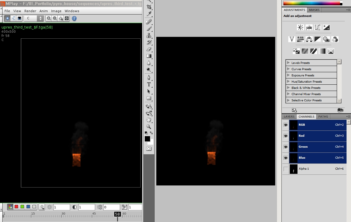

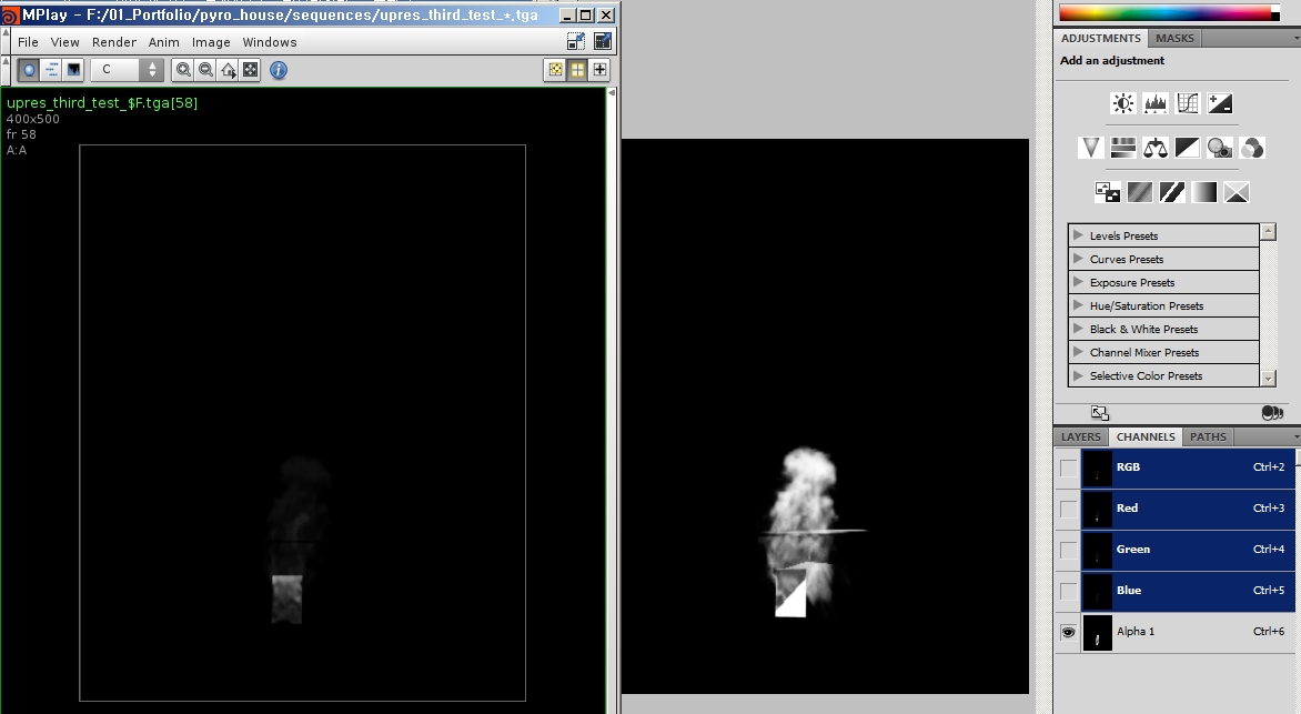

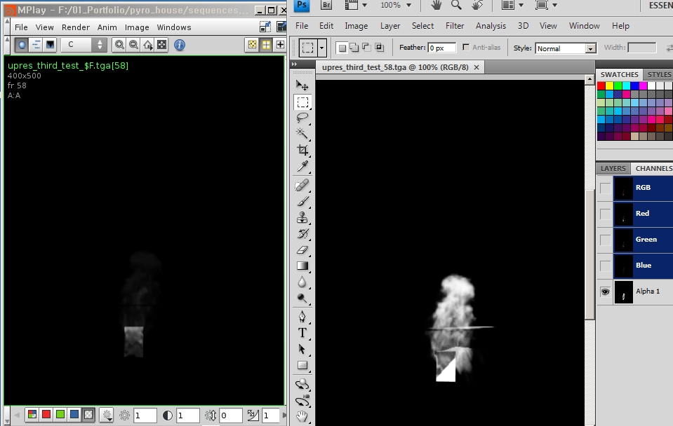

syfake Posted March 12, 2010 Share Posted March 12, 2010 (edited) you can see attached files. there are same frame images. but, alpha channel look is different between mplay and other apps(photoshop, nuke, afterfx etc..). What is the cause of this? Edited March 12, 2010 by syfake Quote Link to comment Share on other sites More sharing options...
edward Posted March 12, 2010 Share Posted March 12, 2010 This is probably assumptions about premultiplied alpha. What happens if you rendered out .tiff files instead? Quote Link to comment Share on other sites More sharing options...
syfake Posted March 12, 2010 Author Share Posted March 12, 2010 (edited) This is probably assumptions about premultiplied alpha. What happens if you rendered out .tiff files instead? thanks edward! it is solved by your advice. Edited March 12, 2010 by syfake Quote Link to comment Share on other sites More sharing options...
