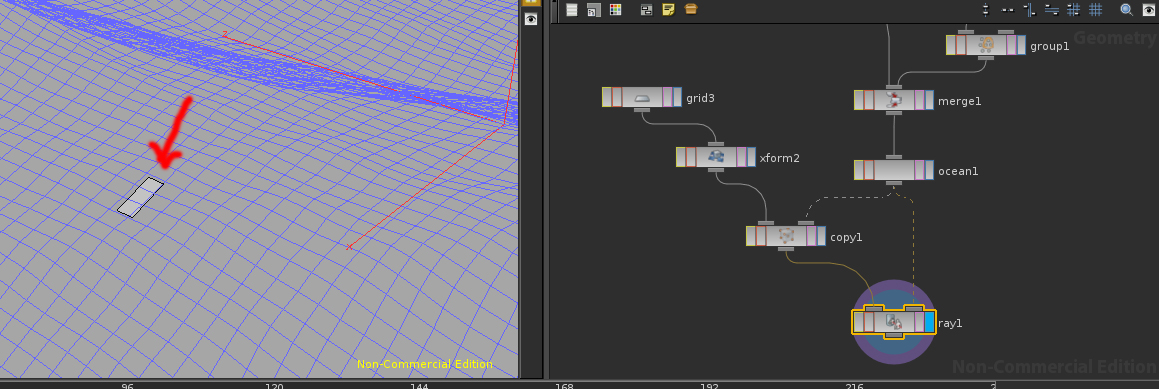

CSN0309 Posted May 30, 2010 Share Posted May 30, 2010 hi~ looks like i got a problem, i attached a tiny grid on a movable surface, (like you see the pic below), so i got this grid to move, but my problem is that i can't get the position information and rotation information from this grid. I want to use those position and rotation information to drive other object, like a boat or something. So, has anyone got idea how to extract those information from this surface~?? Many thinks Quote Link to comment Share on other sites More sharing options...

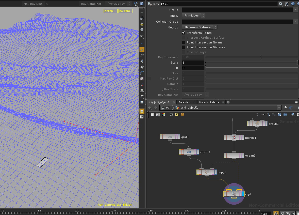

CSN0309 Posted May 30, 2010 Author Share Posted May 30, 2010 see this large pic Quote Link to comment Share on other sites More sharing options...
aracid Posted May 31, 2010 Share Posted May 31, 2010 Hi there you could just project one point using ur ray sop and then copy your boat onto that point, the copy sop will use the position of that point and if u activate "Point intersection normals" on the ray sop, it will keep the inclination of the grid. would that work for you? Quote Link to comment Share on other sites More sharing options...
aracid Posted May 31, 2010 Share Posted May 31, 2010 Hi there you could just project one point using ur ray sop and then copy your boat onto that point, the copy sop will use the position of that point and if u activate "Point intersection normals" on the ray sop, it will keep the inclination of the grid. u might find that increasing the sampling and the jitter scale is needed to resolve the jerky movement of the change in normal as the point moves along the surface. would that work for you? Quote Link to comment Share on other sites More sharing options...
CSN0309 Posted May 31, 2010 Author Share Posted May 31, 2010 thank you aracid~ nice tip!!! select a point by grouping, and copy an object on this selected point. thank you Quote Link to comment Share on other sites More sharing options...
