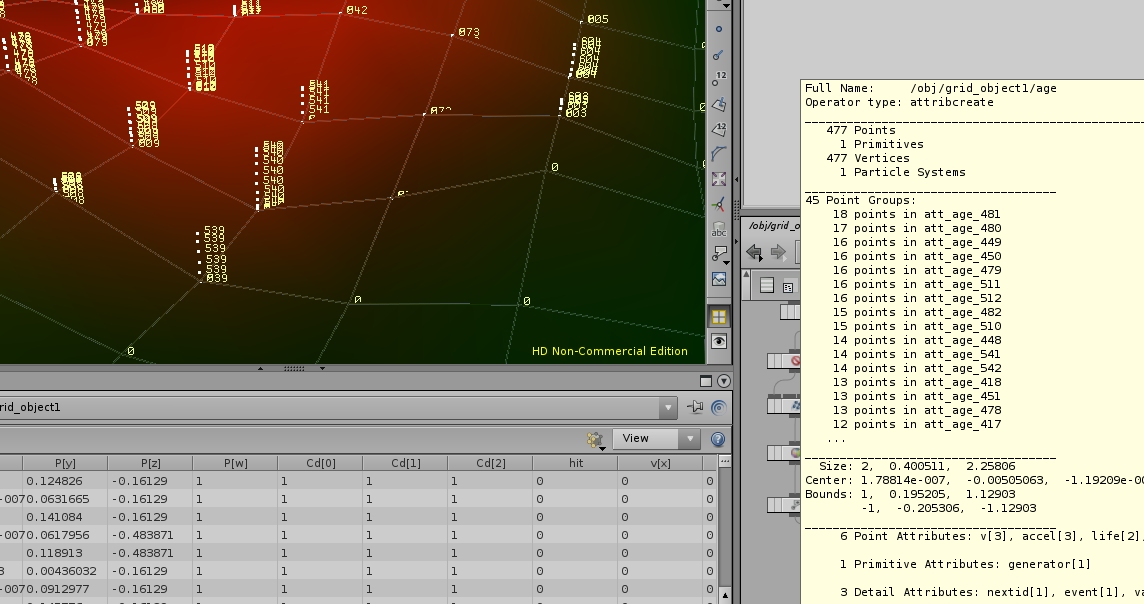

ikarus Posted July 15, 2010 Share Posted July 15, 2010 in the past if i wanted to use a sop solver with deforming geometry i would just create a copy of the geo, having it non-animated, and use that as the place-holder for the sop solver, then i would dop import that and copy the attributes to the deforming version would this solution not work for you? Quote Link to comment Share on other sites More sharing options...
Macha Posted July 16, 2010 Author Share Posted July 16, 2010 (edited) Interesting idea Ikarus, I'll give it a go. Here's what I did with it: Edited July 16, 2010 by Macha Quote Link to comment Share on other sites More sharing options...
