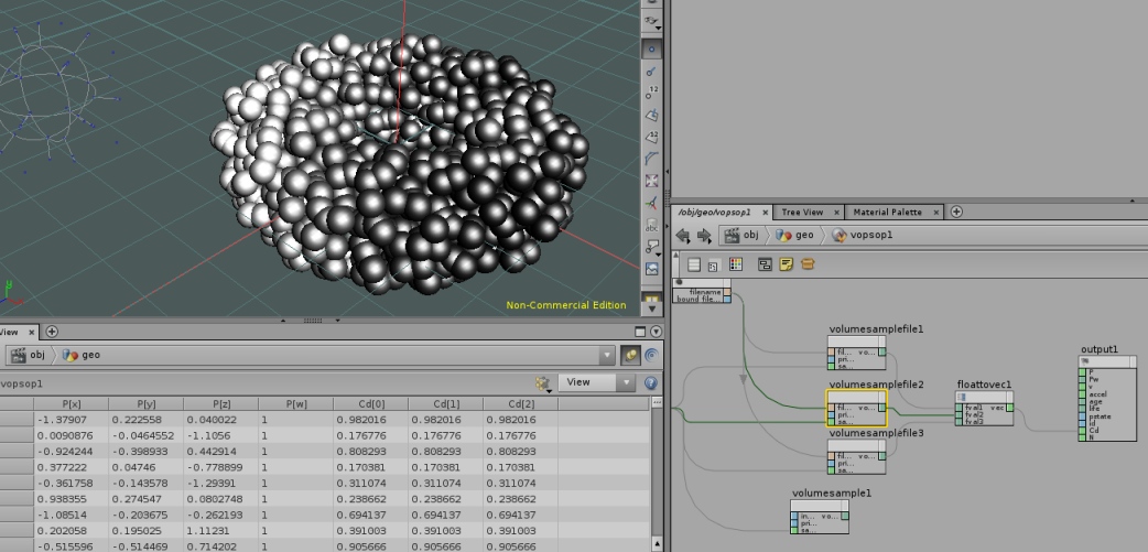

Macha Posted July 19, 2010 Share Posted July 19, 2010 (edited) screenshot. If you look at the Cd values, the scattering seems to be almost exactly isotropic and I don't seem to be able to control that effect much. Is that expected or did I make a mistake in the setup? Edited July 19, 2010 by Macha Quote Link to comment Share on other sites More sharing options...

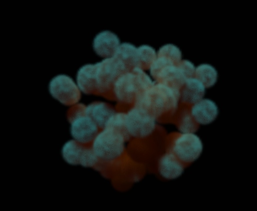

bunker Posted July 19, 2010 Share Posted July 19, 2010 Hey Macha, what I really meant was that : - create an empty lowres volume - add the density from point cloud ( in a volume vop, pcopen/pcfilter ) - use the volume bake to create shadows and scattering - now create a hires empty volume - merge it with the Cd.x,Cd.y,Cd.z from the volume bake - in the volume shader, lookup a bgeo file with the points to re-create hires density ( that allows to mix lowres shadows+scattering with hires density ) - the trick is the transform in the shader ( in blue ) have a look points_to_clouds.hipnc Quote Link to comment Share on other sites More sharing options...
bunker Posted July 19, 2010 Share Posted July 19, 2010 (edited) That's a bit better ... points_to_clouds2.hipnc you should also have a look at the "meta-loop Import", it works with metaballs : http://www.sidefx.com/docs/houdini9.5/nodes/vop/metaimport http://www.sidefx.com/index.php?option=com_forum&Itemid=172&page=viewtopic&p=9110 Edited July 19, 2010 by bunker Quote Link to comment Share on other sites More sharing options...

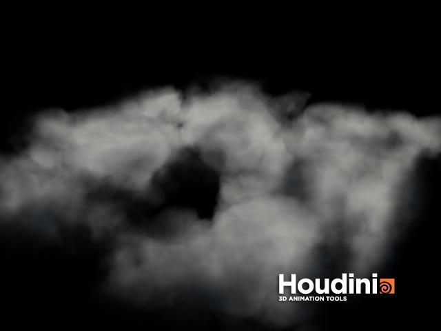

ikarus Posted July 21, 2010 Share Posted July 21, 2010 i happen to puts around with particles to volumes the other day and i have this method, its rather straight forward though i think bunker's solution is cleaner, probably want to integrate his ideas into mine eventually basically i had a low res fluid sim advect a POPnet with the same emitter, then the point density is calculated through a PC iterator; i also multiply it based on the life of the particle. then i have a volume based on the bbox of the particles, and density is picked up through a pc loop, though ive seen nice results from meta-loops which i might add later. particle_to_volume.hipnc Quote Link to comment Share on other sites More sharing options...
