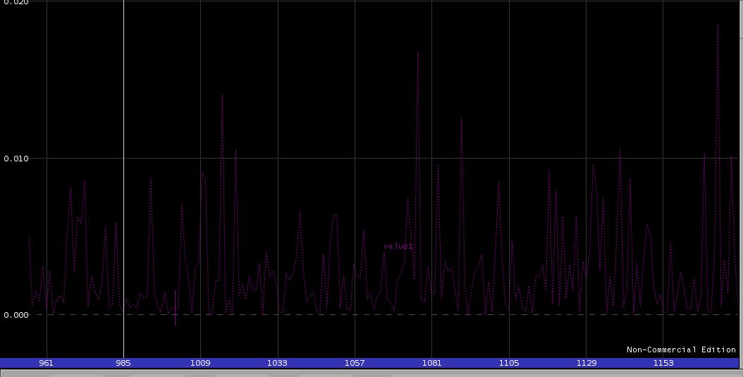

Macha Posted October 25, 2010 Share Posted October 25, 2010 Yes, it's odd this. It obviously depends on the input positions but it should at least go negative and it never does. It's interesting but unfortunately I have no time at the moment to pursue this. Anyway to help debug this I attached a setup that visualizes the problem. Left-click on the attribute value. vop_turbulent_noise_v1.hipnc Quote Link to comment Share on other sites More sharing options...

3dbeing Posted October 27, 2010 Author Share Posted October 27, 2010 Thanks for the file Macha excellent idea visualizing the output in a graph. Johenr, I see now if I increase the size and the resolution of the sphere to a dramatic level I do get a bounds of roughly (0,1). I guess the docs are a bit misleading. Thanks for the help guys... Quote Link to comment Share on other sites More sharing options...
