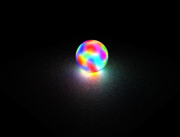

Tannins Posted November 12, 2010 Share Posted November 12, 2010 Just wondering how to get objects (like a simple sphere) to emit light or glow? Quote Link to comment Share on other sites More sharing options...
Macha Posted November 12, 2010 Share Posted November 12, 2010 Try this. spherelight.hipnc Quote Link to comment Share on other sites More sharing options...
Macha Posted November 12, 2010 Share Posted November 12, 2010 Or this. Or do it in post. spherelight2.hipnc Quote Link to comment Share on other sites More sharing options...
Tannins Posted November 15, 2010 Author Share Posted November 15, 2010 That first one worked well... how would I instance that sphere to particles? Quote Link to comment Share on other sites More sharing options...
RontheDon Posted November 15, 2010 Share Posted November 15, 2010 That first one worked well... how would I instance that sphere to particles? One way would be the good ol' copySOP alternatively you could instance geo at rendertime - really depends on what you need Quote Link to comment Share on other sites More sharing options...
bunker Posted November 15, 2010 Share Posted November 15, 2010 The light from geometry works well but it's also very slow IMO. If you want faster lighting, use a pointcloud lookup in a shader. There is a good example here (sparks) : http://ihoudini.blogspot.com/ 1 Quote Link to comment Share on other sites More sharing options...
