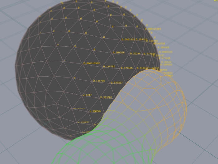

Macha Posted November 19, 2010 Share Posted November 19, 2010 (edited) And a screenshot. It appears to work. If you change the metaball's kernel function the attributes appear to change correspondingly. Edited November 19, 2010 by Macha Quote Link to comment Share on other sites More sharing options...

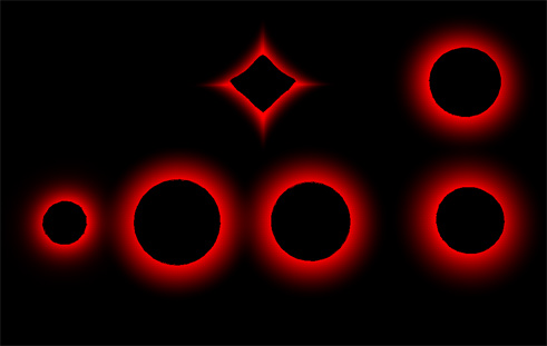

Macha Posted November 19, 2010 Share Posted November 19, 2010 Various kernels and exponents Quote Link to comment Share on other sites More sharing options...
