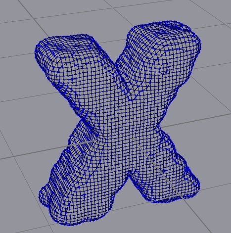

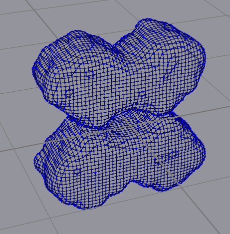

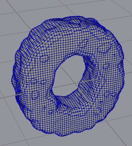

Macha Posted December 9, 2010 Share Posted December 9, 2010 (edited) Here is one way. Another one would be to use a sort sop and particles, or blend volumes, or... meltox.hip Edited December 9, 2010 by Macha Quote Link to comment Share on other sites More sharing options...

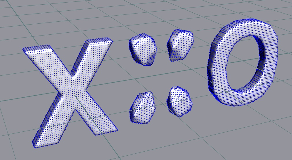

Macha Posted December 10, 2010 Share Posted December 10, 2010 Here is another method. I like that one best. I also tried the volumesurface but from what I understand it creates a surface by growing from a seed, so if the shapes are not connected it will only surface part of the volume. This happens when X and O blend (there are 4 separate objects). volumexo.hip Quote Link to comment Share on other sites More sharing options...
