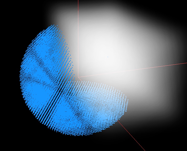

Tiago Posted February 9, 2011 Share Posted February 9, 2011 Hi, How can I do a bounding box with feathered edges, in regular SOP mode. I tried using a fog volume but to no avail... Thank you, T Quote Link to comment Share on other sites More sharing options...
Macha Posted February 9, 2011 Share Posted February 9, 2011 (edited) Volume will "feather" by default if the resolution is low enough. Otherwise, try the volume blur sop, volume vop, or volume visualize. Perhaps you mean something slightly different though? Edited February 9, 2011 by Macha Quote Link to comment Share on other sites More sharing options...
Tiago Posted February 9, 2011 Author Share Posted February 9, 2011 Thanks for your help Marc. What I meant was I couldn't use that fog as bounding box (to clip information from some geometry for instance...) Quote Link to comment Share on other sites More sharing options...
Macha Posted February 9, 2011 Share Posted February 9, 2011 (edited) Like this? Edit: Oh, and I just realized, there is a feather volume sop. vol.hipnc Edited February 10, 2011 by Macha Quote Link to comment Share on other sites More sharing options...
Tiago Posted February 10, 2011 Author Share Posted February 10, 2011 Like this? Edit: Oh, and I just realized, there is a feather volume sop. Exactly that! Thanks again Quote Link to comment Share on other sites More sharing options...
