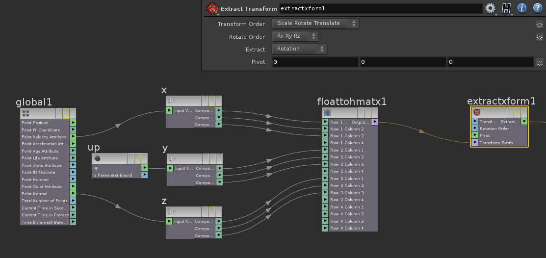

lets say we have a point with velocity, up, and normal vectors representing x y z.
then the point is being rotated with more than one transform node.
how do I get combined rotations values if I needed to use only one transform node to set point rotations?
the example will illustrate this confusing question I am trying to ask :)
I was thinking maybe VOPs extractxform vop, but I have no idea how to use it...
anyway, please share if you have any ideas.
combinedRotations.hip
Edited by PhasmaCeritus
Multiply matrices?
I was hoping to get combined rotation values expressed in degrees or radians.
Anyway i figured this out, I just needed to feed my rotated vectors into extractxform vop and switch it to extract rotations.
Attaching network picture if somebody will run in to the same problem as I did :)
cheers
