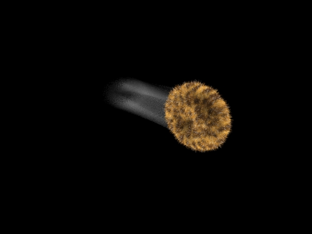

David Cordeiro Posted February 23, 2011 Share Posted February 23, 2011 (edited) Hello, sorry if this seems a noob question but, iv'e pulled my hair for some time and searched and googled about-it and cant understand-it. im testing thefur tool on the default shelf on a simple animated torus and cant get -it o have motion blur. I enable geometry velocity blur on the fur object an nothing happens... Can someone please point-me to the right direction ? Edited February 23, 2011 by David Cordeiro Quote Link to comment Share on other sites More sharing options...
Darric Posted February 24, 2011 Share Posted February 24, 2011 Are you sure you're rendering from a Mantra node with "Allow Motion Blur" enabled, and "Geo Time Samples" at least 2? Quote Link to comment Share on other sites More sharing options...
David Cordeiro Posted February 24, 2011 Author Share Posted February 24, 2011 Thanks I had the geo time samples at 1. Quote Link to comment Share on other sites More sharing options...
yongbin Posted February 28, 2011 Share Posted February 28, 2011 Thank you! I searched it for several month. The geo time samples! Quote Link to comment Share on other sites More sharing options...
Darric Posted March 1, 2011 Share Posted March 1, 2011 It's a funny thing. As I understand it (and I might be wrong here) that setting shouldn't even affect velocity motion blur, and as best as I can tell, nothing with deformation blur will blur with it set to the default of 1. So why doesn't it default to 2? Maybe someone with more intimate knowledge of motion blur can help out here. Quote Link to comment Share on other sites More sharing options...
