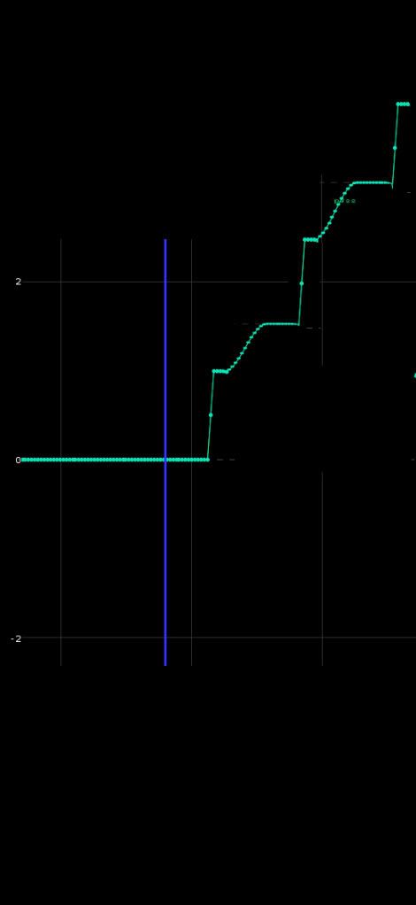

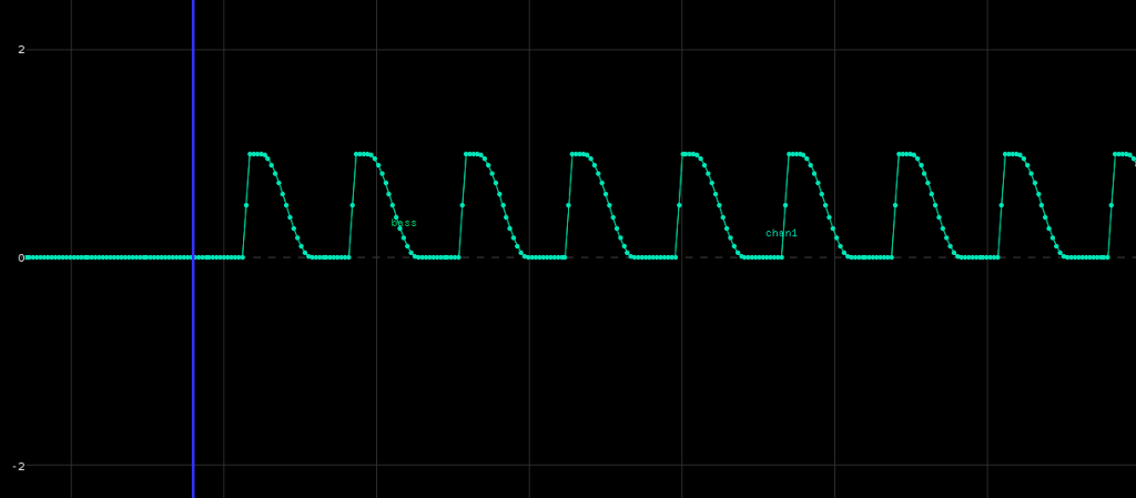

breadbox Posted April 4, 2011 Share Posted April 4, 2011 (edited) anyone know how i can create an additive value for a channel / music track so that for example say I would like to take this bass track graph and on every peak have it add to the channel value but never subtract. so that if I were to pipe this into the rotation value of an object it would continue to rotate in the same direction and on every peak it would speed up the rotation. here is a picture of my graph. http://i245.photobucket.com/albums/gg54/bradonwebb/Channel_operator.png roughly I'd like the output to look something like this. http://i245.photobucket.com/albums/gg54/bradonwebb/Channel_operator_additive.jpg Edited April 4, 2011 by breadbox Quote Link to comment Share on other sites More sharing options...

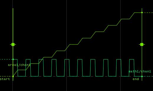

symek Posted April 4, 2011 Share Posted April 4, 2011 (edited) I think the AreaCHOP is what you're after. hth, skk. Edited April 4, 2011 by SYmek Quote Link to comment Share on other sites More sharing options...

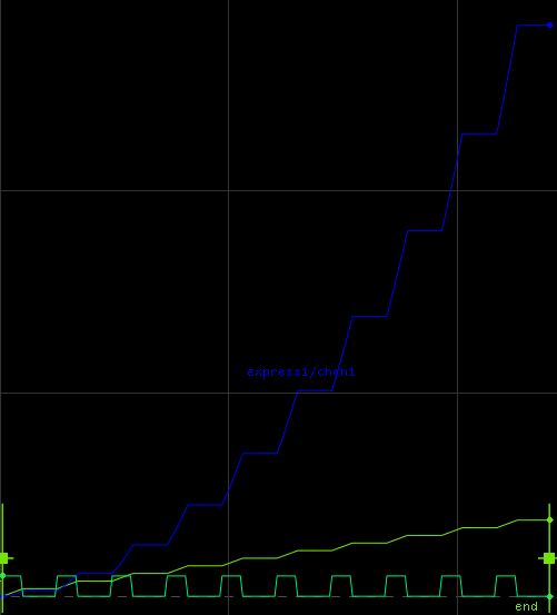

Macha Posted April 4, 2011 Share Posted April 4, 2011 Try this Bradon. chopadd.hipnc Quote Link to comment Share on other sites More sharing options...
Macha Posted April 4, 2011 Share Posted April 4, 2011 The expression node (blue) makes it speed up if that's what you want. Quote Link to comment Share on other sites More sharing options...
