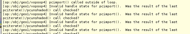

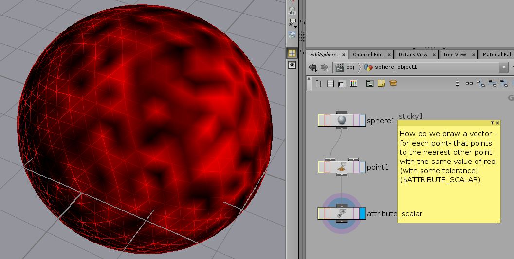

Macha Posted April 21, 2011 Share Posted April 21, 2011 (edited) I have some geometry with many points. Each point has an $ATTRIBUTE_SCALAR. I want to create another vector $ATTRIBUTE_VECTOR that points to the nearest $ATTRIBUTE_SCALAR with the same value. For example: -Point 12 has $ATTRIBUTE_SCALAR = 1 In it's neighbourhood we have Point 11 with $ATTRIBUTE_SCALAR = 0.5 Point 35 with $ATTRIBUTE_SCALAR = 1 Point 785 with $ATTRIBUTE_SCALAR = 0.3 Then we would draw a vector from point 12 to point 35, and store it in $ATTRIBUTE_VECTOR because they have equal $ATTRIBUTE_SCALAR value. Now, I thought this would be easy peasy with a point cloud and while loop but it turns out we cant write attributes inside such a loop. I get the error below. It's likely there are multiple possible values for each point's $ATTRIBUTE_VECTOR, but I am not concerned about that for now (although even better if somebody finds a solution for that too!). I just need one vector (any of them). So we don't need to worry about that. How can I do this? Edited April 21, 2011 by Macha Quote Link to comment Share on other sites More sharing options...
