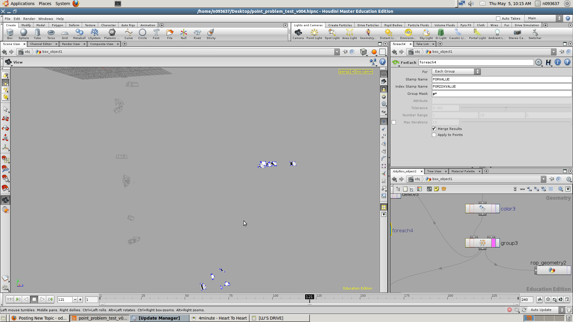

Hi all, I am trying to create a secondary fracture. I did all the pre-fracture work inside a foreach node. And further inside a foreach node, I created a point for each secondary pre-fractured piece. Then I used a point node to make the point position move over time. But I encountered a problem when I used a copy sop to copy the geometry onto the points. The geometry piece somehow moves away from the original geometry. And when I plugged the foreach node together with the original geometry node, the geometry pieces somehow "spawn" in mid air. Could someone tell me how to solve it? Thanks.
I added a screenshot to further describe what I am trying to say.
Thanks.
point_problem_test_v004.hipnc
Just gave it a quick look but but it seems something is happening here :
obj/box_object1/foreach4/foreach1/point1
You multiply position of your fragments by time which seems to give you this unexpected offset.
But maybe I'm missing something ...
