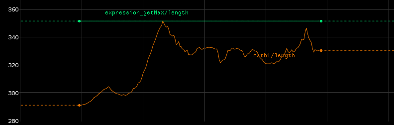

Symbolic Posted August 7, 2011 Share Posted August 7, 2011 Hi, I have one single channel in CHOPs that goes between 270 and 362. There is a moment that I get the max value. I would like to be able to return the FRAME number at that particular moment as my value goes to its maximum level. Any ideas? Thanks. (In the attached image we can clearly see the moment the "value" (orange line) "hits" the max value (green line). I would like to be able to return the $FF at that moment.) Quote Link to comment Share on other sites More sharing options...
anim Posted August 7, 2011 Share Posted August 7, 2011 this will do that easily, but remember, you can have more frames with the maximum value, this will detect all of them but return frame for the last one chops_detect_max_value_frame.hip Quote Link to comment Share on other sites More sharing options...
Symbolic Posted August 7, 2011 Author Share Posted August 7, 2011 Hi anim! Thanks for the help! Works perfectly. I was just starting to think that I will waste my entire Sunday trying to figure this out and there is no one around to help me. This was a real life saver. Thanks. Quote Link to comment Share on other sites More sharing options...
