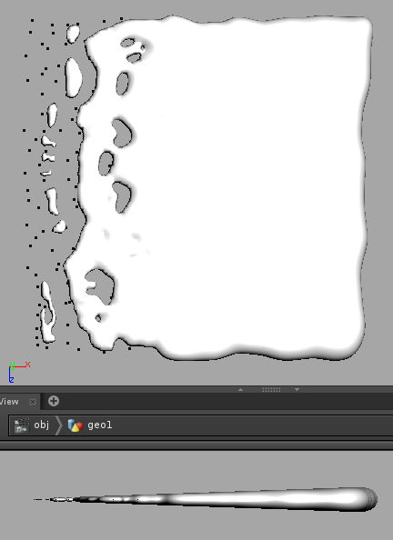

Hi everyone,
I'm wondering if there is a way to specify point attributes before a particleFluidSurface node in order to control its behaviour.
What I mean is:
if I specify "pscale" I can control the "Point Radius Scale" inside particleFluidSurface node... (see image below where I specified pscale based on $BBX) but it seems this is the only point attribute that is read from particleFluidSurface node.
Do you know if there is a way to make also "step size", "surface distance" and "filtering" driven by point attributes?
Or if there is a way to control them using point() or something similar? (I tried to put $PT inside a point() expression but is not a variable that particleFluidSurface recognises)
Cheers,
Emanuele
Edited by Emanuele Berti
i'm pretty sure all of the controls for pfsurface are static and can't be modded on a per-point basis. (I'd make a guess it just runs a meshing kernel though a uniform grid which the particles are splatted onto)
the volume surface node gives you extra controls for adaptive meshing schemes, although that requires a volume to begin with...
