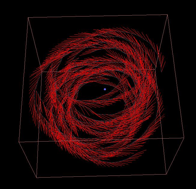

I have a spline of spring which have velocity like below.
caculated v from it and made it to follow smoke emitter to have the vortex force continuesly.
and using attribefromvolume sop to make v to vel so I can read them in sopvectorfield dop in smoke simulation.
I got it correctly but it does not update it's position like I see in sop network in dop network.
It just stay in 0,0,0 where I created the spline at the firsttime.
I made the sop path of sopvectorfield path to be "set always" and gas calculate dop 's calculation to be add and "set always" as well.
I dont know what I am missing to fetch the velocity of the spline to be updated every frame.
