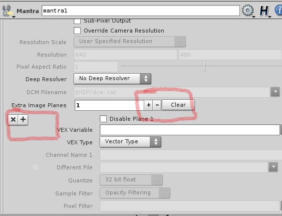

Hello world Posted November 10, 2011 Share Posted November 10, 2011 (edited) I have a doubt.I want to add some parameters such as the one given below in the image(attachment) to my hda.I dint see any options to add paramaters like this in the edit parameter interface window. and I would also like to know how the other parms are created when the user clicks the + button. Please help me out.Thank you Edited November 10, 2011 by Hello world Quote Link to comment Share on other sites More sharing options...
graham Posted November 10, 2011 Share Posted November 10, 2011 Those parameters are called Multiparm blocks. They are folder parameters whose contents is instantiated based on a number of entries. To create them you just need to add a folder and set the Folder Type to one of the Multiparm Block types. The one above is a list. If you then add parms to this folder and hit Apply, you will see something similar to the above picture that lets you add the bunches of parms. Quote Link to comment Share on other sites More sharing options...
hopbin9 Posted November 11, 2011 Share Posted November 11, 2011 You can also reference those params in the disable when rules by using a # symbol to represent the folder entry. Quote Link to comment Share on other sites More sharing options...
