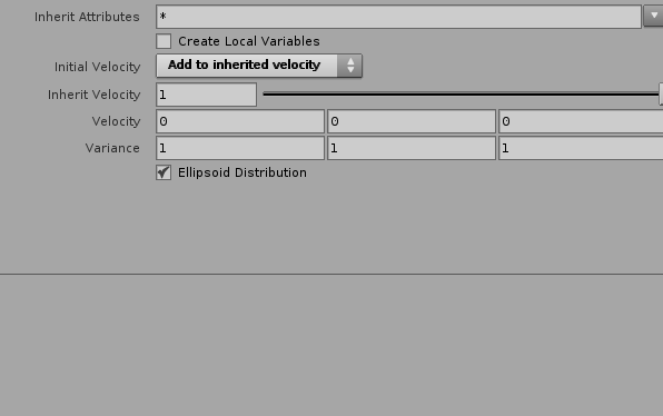

sanchoflat Posted April 16, 2012 Share Posted April 16, 2012 what did you here: maybe the problem is in "variance" Quote Link to comment Share on other sites More sharing options...
