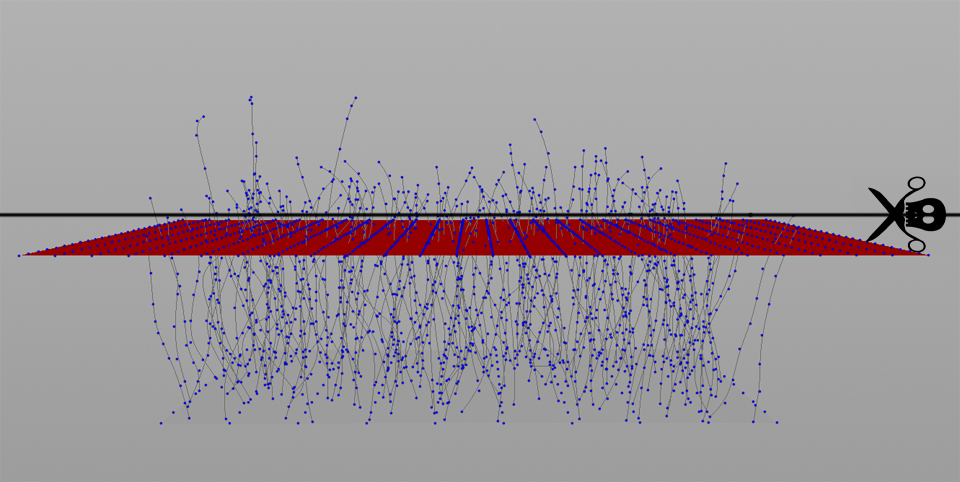

infinity_spiral Posted May 28, 2012 Author Share Posted May 28, 2012 Hi again, Hope this time to get more responses. I was able to convert the baked cloth geometry to static RBD object and I've got some collusion on the the hair.But I still have a problem with penetrating hair trough the cloth. So can someone give me a hint how to delete the hair that is penetrating to the moving cloth at render time(The length and the cut map are not a option I tried them and don't work well ).In SOP level this shouldn't be so difficult, maybe just finding points in volume in VEX and than deleting them with delete SOP, but in render time this all has to happen inside VEX and as I know we can't delete or create points inside it, also I don't have an access to Fur Procedural in VOP level. So I hope someone can give me some idea how to achieve that. This image shows what I want to do: Quote Link to comment Share on other sites More sharing options...
