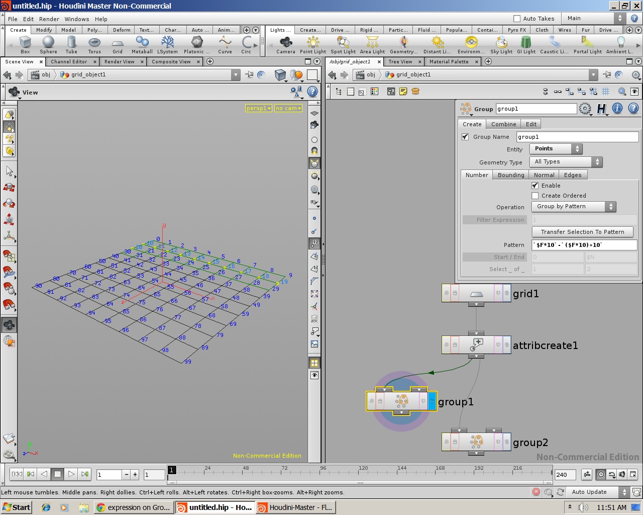

I am trying to select with expression on Pattern of Group Sop.
like ,
`$F*10`-`($F*10)+10`
so I get 10-20 , 20-30 , 30-40 , as frame increase but this expression is not working in the tab.
Tried to make local attribute for $F*10 as $SELX and $F*10+10 as $SELY and put
`$SELX`-`$SELY`
and it is also not working.
But
`$F`-10
is working in pattern of Group sop which mean local variable is working..?
It works with Global Expression variables. Also you can use expressions (pointlist, primlist ... etc) which gives the list of point numbers or primitive numbers .
`$F*10`-`($F*10)+10` is working fine.
