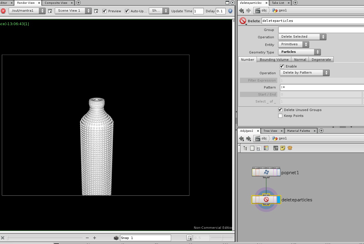

nazar Posted June 21, 2012 Share Posted June 21, 2012 hi all! the actual question in the title, a picture is attached I work in Houdini 12 who's seen it? thank you in advance! Quote Link to comment Share on other sites More sharing options...

Green-Man Posted June 21, 2012 Share Posted June 21, 2012 (edited) Where is the problem? Could you be more specific, please? If you want just to delete your particles with the Delete SOP you should change Entity to Points instead of Primitives. Edited June 21, 2012 by Green-Man Quote Link to comment Share on other sites More sharing options...
nazar Posted June 21, 2012 Author Share Posted June 21, 2012 (edited) the particles are visible in the picture. and they should not be there. in 11 Houdini was not like this when the subject turns into a soft body by POP and SoftBody (see pictures num. one) particles should not be rendered by default my English is bad, I know, sorry Edited June 21, 2012 by nazar Quote Link to comment Share on other sites More sharing options...
Green-Man Posted June 21, 2012 Share Posted June 21, 2012 Sorry. You should delete not the Points entity. But the 0 primitive that contains particle system. Quote Link to comment Share on other sites More sharing options...
nazar Posted June 22, 2012 Author Share Posted June 22, 2012 yeah, worked! thank you! Quote Link to comment Share on other sites More sharing options...
