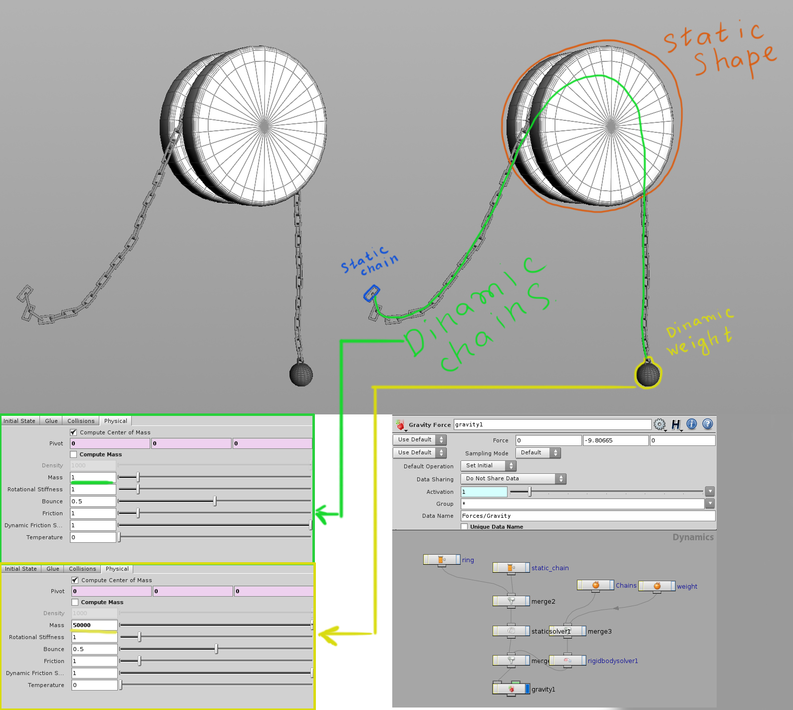

cool1986vfx Posted August 7, 2012 Share Posted August 7, 2012 (edited) hey everyone! I have problem with mass RBD, I many times try to simulate effect chains with big massive for making stretch chains, and this is now work( maybe need extra settings for Frictionless or any alse have any ideas? can You are help me please) Thanks Best Regards Evgeny. Mail me cool1986vfx@gmail.com skype: cool1986vfx Edited August 7, 2012 by cool1986vfx Quote Link to comment Share on other sites More sharing options...

thinkinmonkey Posted August 8, 2012 Share Posted August 8, 2012 Hi cool, I had a similar problem time ago, the only solution I came with the community was the solution proposed by the artist Fabiano Berlim. You can read it here: solution for a dynamic chain It's tricky, not a complete solution, but it worked flawlessly. Ciao Quote Link to comment Share on other sites More sharing options...
cool1986vfx Posted August 8, 2012 Author Share Posted August 8, 2012 (edited) Thanks Thinkinmonkey ! I try this method and this is work fine, but this is not what I need( I am need RBD, because, I want make this chains for close shot, and Need exactly see phisics on colision and see offsets betwin chains( Also, I spend 1 day for simulate this dynamics and through 300 frames its start works and fall down, very interesting, maybee Its confuse , and maybe this is really works. Evgeny. Edited August 9, 2012 by cool1986vfx Quote Link to comment Share on other sites More sharing options...
