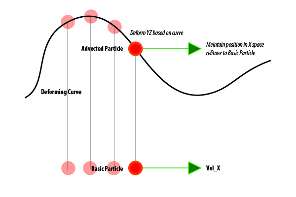

Wooshum Posted September 6, 2012 Author Share Posted September 6, 2012 When you say "maintaining its current velocity" do you mean relative to the curve? Had to do an image to work this one out! I am trying to have the affected particle travel in world(x) relative to the velocity of the unaffected particle; or rather maintain the current position and velocity in world(x) as the unaffected particle whilst following the deformations of the curve in world(xy).(see below) Quote Link to comment Share on other sites More sharing options...
ikarus Posted September 6, 2012 Share Posted September 6, 2012 Like so? deformation_transfer.hipnc Quote Link to comment Share on other sites More sharing options...
3__ Posted September 6, 2012 Share Posted September 6, 2012 this is very hacky, but might give you the desired result... Particle_pathfollow.hipnc Quote Link to comment Share on other sites More sharing options...
Wooshum Posted September 6, 2012 Author Share Posted September 6, 2012 (edited) Best community ever - I have gone with ikarus's solution in this instance as I am deforming at a SOP level. There is a little jitter on the points after the deform, nothing the CHOPs filter cant fix though. Thanks heaps! Edited September 6, 2012 by Wooshum Quote Link to comment Share on other sites More sharing options...
