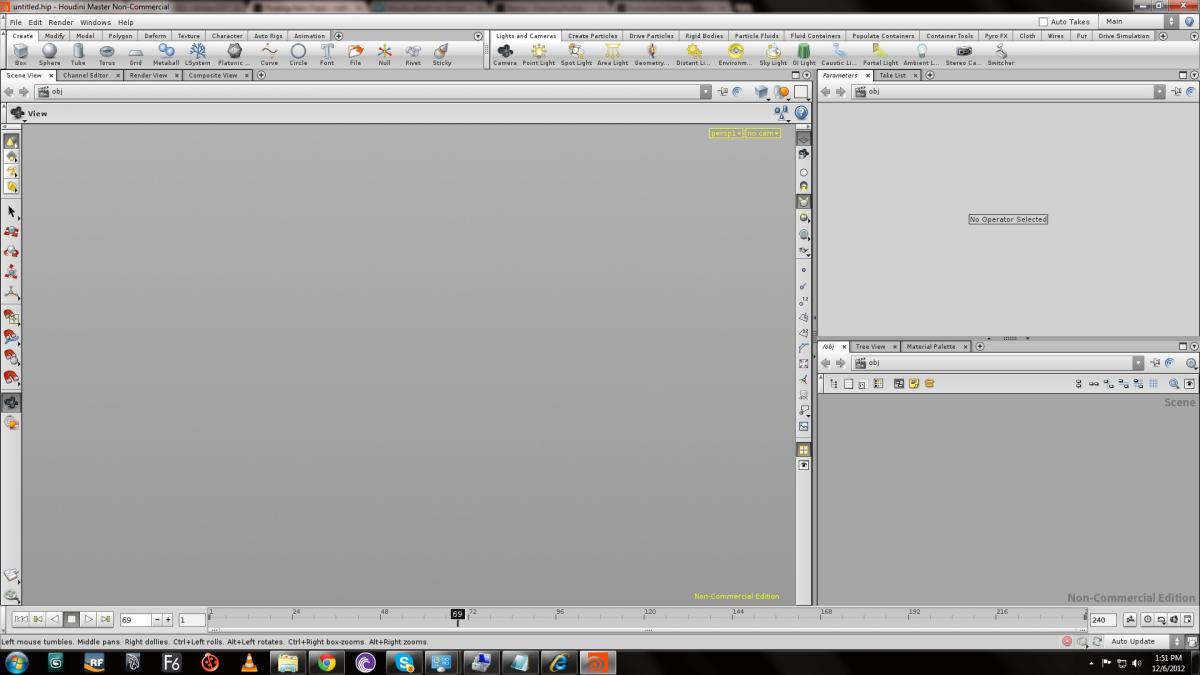

kumar20102010 Posted December 6, 2012 Share Posted December 6, 2012 Hi, My name is prasanna kuamr and i am new to Houdini,so my problem is like i have installed houdini12 and i cannot see the grid and objects in the viewport so can any one help me please. Thank's. Quote Link to comment Share on other sites More sharing options...
RogerW Posted December 6, 2012 Share Posted December 6, 2012 Hey, I would assume though that it is some sort of graphics card driver conflict, you can try updating your driver or try changing your scene renderer to H11 by going to edit > preferences > 3d viewports > scene renderer > H11 or one of the other options. you might have to restart houdini for the settings to take effect, but I haven't tested this. Just to be safe make sure that you are at the default start up camera position by pressing "spacebar + h" so that you know your grid should be visible. Hope it helps. Quote Link to comment Share on other sites More sharing options...
malexander Posted December 6, 2012 Share Posted December 6, 2012 What graphics card and driver are you running? As Roger suggested, try updating the graphics driver first. Older graphics drivers (especially more than 2 years old) can be a source of problems. Quote Link to comment Share on other sites More sharing options...
freaq Posted December 6, 2012 Share Posted December 6, 2012 also try switching viewport modes from openGL to H11 or to another openGL >> edit > preferences> 3dviewports Quote Link to comment Share on other sites More sharing options...
