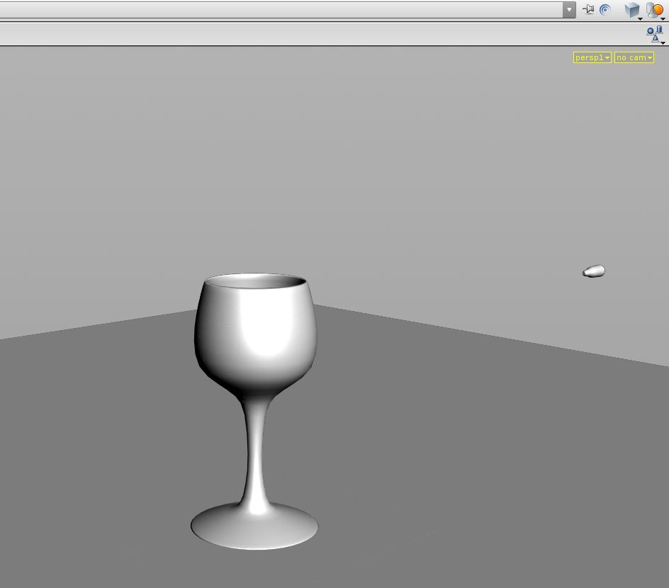

mergen Posted February 5, 2013 Share Posted February 5, 2013 Hi all! I've little bit question about fracture exporting. I simpely shattered a glass, but finally I export to Maya the shading it's not correct, Like Images... so Any one tell what can i do? I don't know what happen to my scene? Quote Link to comment Share on other sites More sharing options...
acey195 Posted February 5, 2013 Share Posted February 5, 2013 Have you explicitly generated normals on you Houdini model? By using a facet node for instance. you can check by using the middle mouse button on the final node. is should say 'N' somewhere in the point or vertex attributes. It can also depend on the format, or import settings you are using to import the glass in Maya. Quote Link to comment Share on other sites More sharing options...
mergen Posted February 6, 2013 Author Share Posted February 6, 2013 (edited) Hi thier is Hip file could you tell me how to do it? maybe my note is wrrong abdusemet.abduqadir@qarluq.comGlass.zip Edited February 6, 2013 by mergen Quote Link to comment Share on other sites More sharing options...
jim c Posted February 9, 2013 Share Posted February 9, 2013 In your glass geo object node, there should be a SOP call dopimport or something like that - this is what's getting the stuff back from the simulation. AFTER this node, add a Facet SOP (right click on the node and look for Facet). Once you've added this node, turn on post computer normal, and maybe pre-compute normals (I don't remember if you need one or both). This should fix the problem. Then save this out to disk. Quote Link to comment Share on other sites More sharing options...
