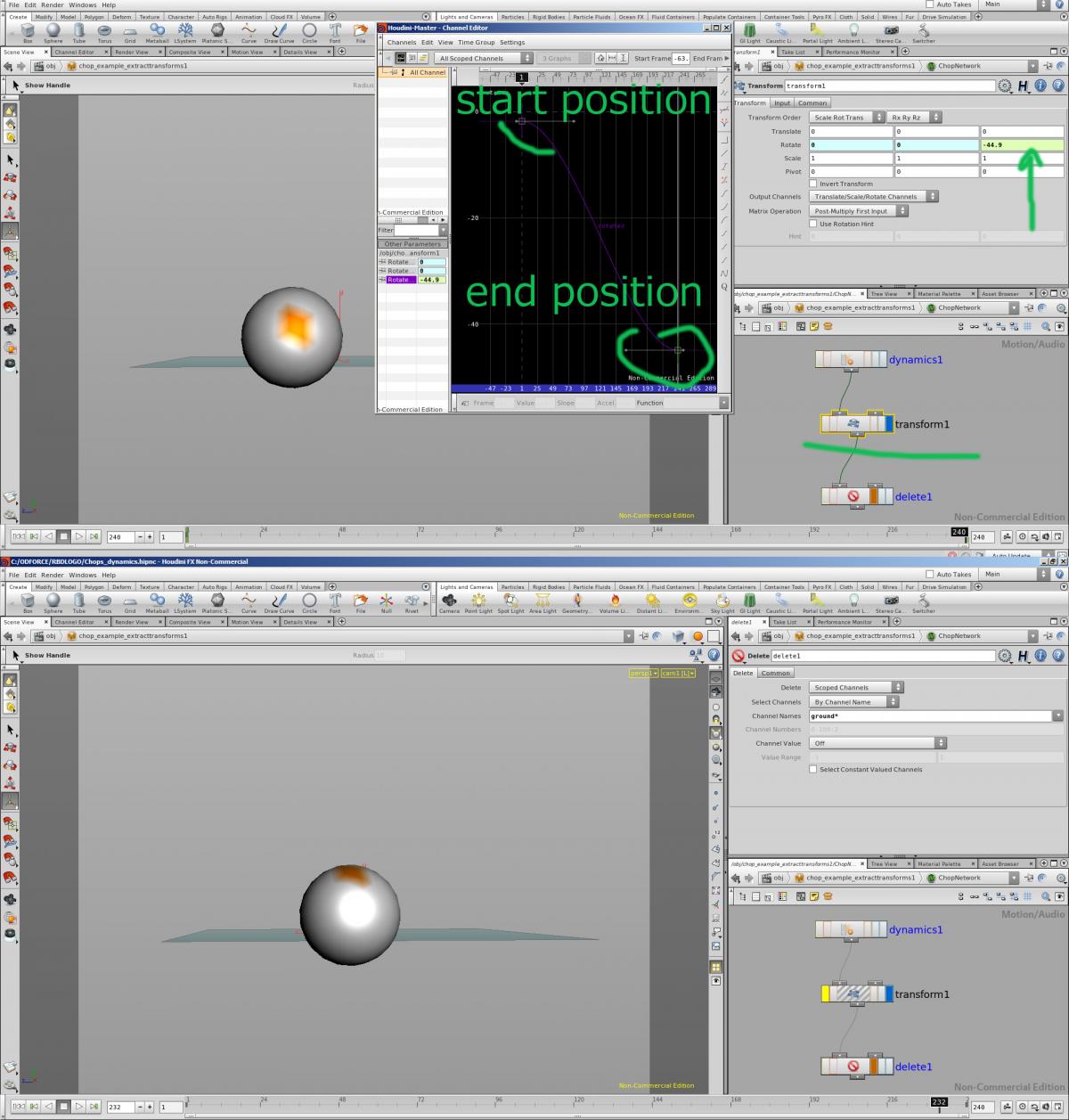

mangi Posted November 18, 2013 Share Posted November 18, 2013 (edited) Hi Juri. You can Use a ChopNetwork & use a dynamics node with a transform node (In the ChopNetwork) and there you can put a couple of keys on the start pose and another on the end pose. On the rotation channel. Here is a hip so you can see how to do it. If your not familiar with this method. This was the second method I though of. The first was using a UV projection and animating that. Maybe there are more methods Cheers Mangi dynamic chops.movFetching info... Chops_dynamics.hipncFetching info... Edited November 18, 2013 by mangi Quote Link to comment Share on other sites More sharing options...
JuriBryan Posted November 19, 2013 Author Share Posted November 19, 2013 Thanks Mangi, this works very well. the rotations end up exactly where I would need them to be, but I tried using transformations inside of the chops as well and the result is swimming to say the least. That is confusing me a bit, since I understood your set up to work like "animation layers", so basically just adding a animation curve to the existing values. but a simple animation curve on the Z-curve adds strange movement differences on x and y as well. Is that just a bug, or is that a limit with the chop set up. I am currently just looking for ways to take more control of my rigid body sims, that is why I have so many questions:) I am just wondering if there are ways to add animations on top of simulations, which is why i tried doing it with velocity updates in a sop solver. to get the right motion from the sim but have the right end position. Cheers, Juri Quote Link to comment Share on other sites More sharing options...
mangi Posted November 19, 2013 Share Posted November 19, 2013 (edited) Juri. (FAST FIX) bake out the simulation to a bgeo sequence , Then you will be able to manipulate the animation curves with a basic Transform node, and not encounter those "strange movement ". Mangi Edited November 19, 2013 by mangi Quote Link to comment Share on other sites More sharing options...
