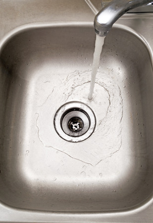

tielax11 Posted July 28, 2014 Share Posted July 28, 2014 I am trying to recreate the effect where running water becomes less opaque at higher speeds, in my instance when coming out of a faucet. For a while before it hits the floor, it is not as transparent as the speed creates bubbles that run with it until it hits the bottom. I have attacthed a picture showing what I am trying to explain. Simply brightening the water based on the particle's velocity is not enough, as you can see streaks the streaks of bubbles in the water, as well as the effect that the lighting has on the water. How would I create this type of effect in Houdini? Quote Link to comment Share on other sites More sharing options...
danw Posted July 28, 2014 Share Posted July 28, 2014 (edited) Take the particles from the original FLIP sim, cull off any below a threshold velocity (-magnitude, so I guess I should say speed), and then ramp speed to pscale to smoothly grow them above that velocity... then render them as instanced spheres along with your surface mesh. In order to keep them inside the water surface, you can set primary visibility off, so they only show up when hit by a refraction ray. Ideally, reverse the inside/outside IOR on the bubble shader, but otherwise it could probably be a straight duplicate of your water shader. (Edit) That should obscure the fast moving water, but it still might not be enough to actually give it that subtle white-ish look... You could try rendering the same spheres as a very faint uniform-volume object, or try dialing a slight hint of subsurface scatter on the bubble water shader. Edited July 28, 2014 by danw Quote Link to comment Share on other sites More sharing options...
