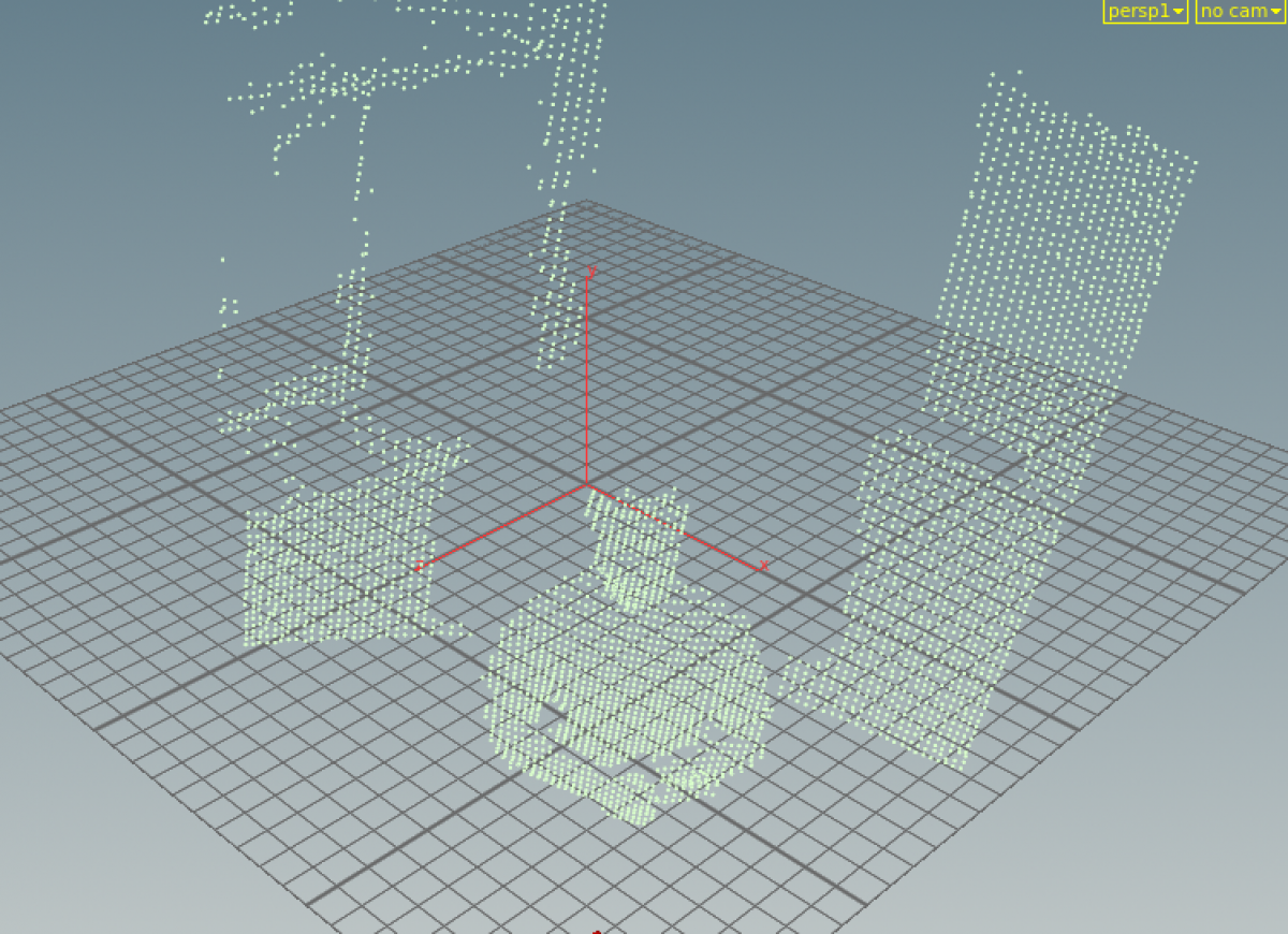

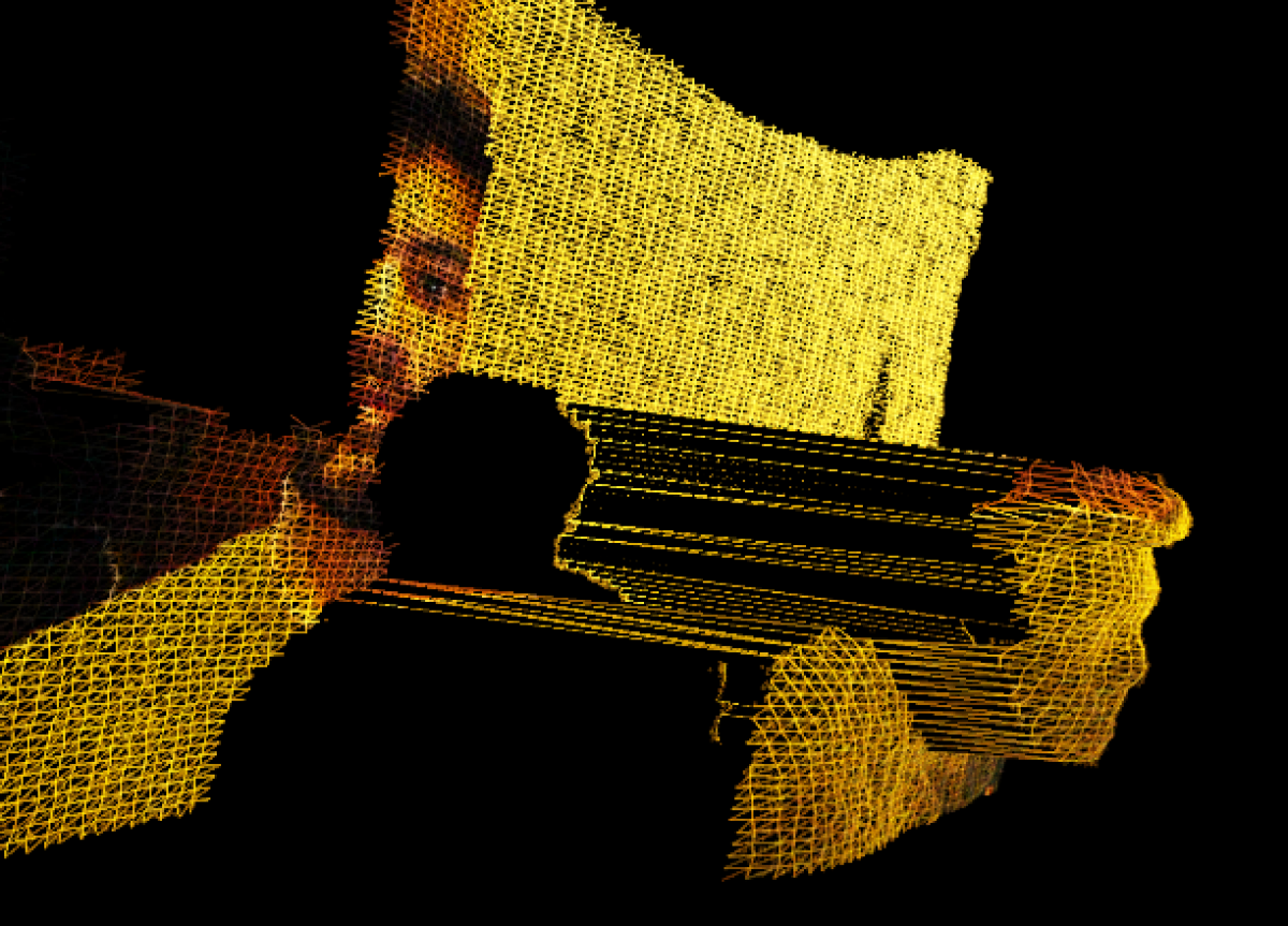

Shuey1971 Posted March 28, 2015 Author Share Posted March 28, 2015 (edited) Use Houdini. For someone who already understands CG theory, it should be much easier. In the video, I see: Some program that connects with the Kinect and outputs the points(?), Houdini for the point effects, Maya (for the environment?), and some compositor being used. But then I just skipped through the video. Probably others as well. If you can get out the point positions to Houdini, then I think Houdini is all you need. Hey thanks for getting back. So I was able to get the points out to Houdini but it looks nothing like my original. It looks like that. While my original looks like the second image Basically it looked like a mesh at first in full geometry settings until I went into the rendering settings and had it display at point cloud. Render>point cloud. Also, Is there a way I can edit each one of those point clouds to be bigger in pixel size or change it's geometry of the individual point? Is there a way I can separate the points? This is project is done in a sequence. It's basically a sequence of .obj. Edited March 28, 2015 by Shuey1971 Quote Link to comment Share on other sites More sharing options...

edward Posted March 28, 2015 Share Posted March 28, 2015 So I was able to get the points out to Houdini but it looks nothing like my original. What do you mean? The point positions look correct from the images you posted to me. Basically it looked like a mesh at first in full geometry settings until I went into the rendering settings and had it display at point cloud. Render>point cloud. Ok, so it looks like a bunch of points and not a mesh because you deleted the mesh!? Is there a way I can edit each one of those point clouds to be bigger in pixel size or change it's geometry of the individual point? Search for "Render as Points" here. So you just set the "width" attribute to a value larger than the default. If you want to render them as spheres, change the "Render as Points" property. Is there a way I can separate the points? Define "separated". A point cloud is by definition unconnected. Quote Link to comment Share on other sites More sharing options...

Shuey1971 Posted March 28, 2015 Author Share Posted March 28, 2015 (edited) @georgeivan Hey thanks, Will look into addSop. @edward Thanks for getting back, Yes, the points may be correct but it doesn't look like what I imported. The colors are off, unless I have to change them. I can't see the vertical lines in my houdini import where I could see them before like this in the image posted. No I didn't delete the mesh I just changed it from full geometry to point cloud. I can change it back and it would look like a solid mesh like object thats filled in. Thanks will look into that "render as point" function and get back with progress. By separation, is there a way I can separate each point from the point cloud to move to a different position in space? Like the cloud is a series of points. Can I move an individual point away, basically subtracting that point? In the first Image I posted. There is a background of point cloud. It's in the movie format. How would I get rid of it? It's a video of point clouds so I'm not sure if I can. @dpap So what I did was use cinder/OpenFrameworks from a program I made to capture the kinect data and then transferred it as an obj file. It was a video and it changed to a png sequence. from there i changed it through my program settings to import the sequence as an obj sequence. Imported then "1-482" obj files as a sequence into Houdini. It became a point cloud 3d object video which is what I wanted. Edited March 28, 2015 by Shuey1971 Quote Link to comment Share on other sites More sharing options...

edward Posted March 30, 2015 Share Posted March 30, 2015 Yes, the points may be correct but it doesn't look like what I imported. The colors are off, unless I have to change them. The .obj file format doesn't support point colors. So you're trying to do a texture look up for the point colors? Offhand, I'm not sure about the support level for texture look ups when rendering points. If you use the .ply file format instead, then you easily add the point colors by naming the "R G B" components as "Cd1 Cd2 Cd3" in the .ply file. Then you can see them in the viewport. I can't see the vertical lines in my houdini import where I could see them before like this in the image posted. The vertical lines? Your Houdini screenshot has *NO* lines. By separation, is there a way I can separate each point from the point cloud to move to a different position in space? Like the cloud is a series of points. Can I move an individual point away, basically subtracting that point? In the first Image I posted. There is a background of point cloud. It's in the movie format. How would I get rid of it? It's a video of point clouds so I'm not sure if I can. Apply any operation that changes the point position, deleting them if you want as well. Also do you know anything that can output the Kinect into Houdini as well? For an OS X user. I've never tried to use the Kinect. Quote Link to comment Share on other sites More sharing options...

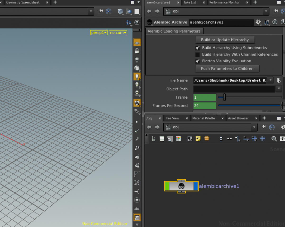

Shuey1971 Posted April 5, 2015 Author Share Posted April 5, 2015 (edited) Hey. So I used Brekel to transfer my data into an Alembic file. The abc file when I tried to import it into Houdini nothing showed up. I've only screenshot half the screen to show the other window. Edited April 5, 2015 by Shuey1971 Quote Link to comment Share on other sites More sharing options...
Shuey1971 Posted April 5, 2015 Author Share Posted April 5, 2015 (edited) Imports perfectly in Maya, but for my purposes I need it to work in Houdini. Edited April 5, 2015 by Shuey1971 Quote Link to comment Share on other sites More sharing options...
