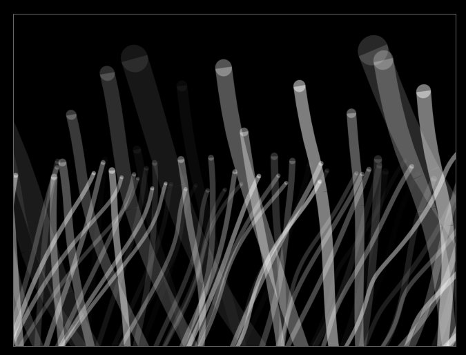

flyaway3d Posted July 28, 2015 Author Share Posted July 28, 2015 Here comes another issue when dealing with Alpha, any idea how to solve this? Quote Link to comment Share on other sites More sharing options...
acey195 Posted July 28, 2015 Share Posted July 28, 2015 well if you use circles that are alligned with the curve, for instance with a "polyframe" node, with the tangent attribute set to N (untoggle the normal attribute) and the up vector towards or directly away from the camera. After that you can set the arc of the circle properly, or use a "clip" node on the circle before copying it. Quote Link to comment Share on other sites More sharing options...
