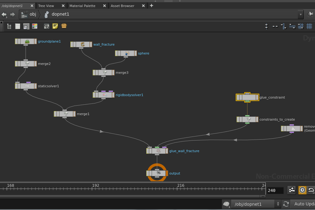

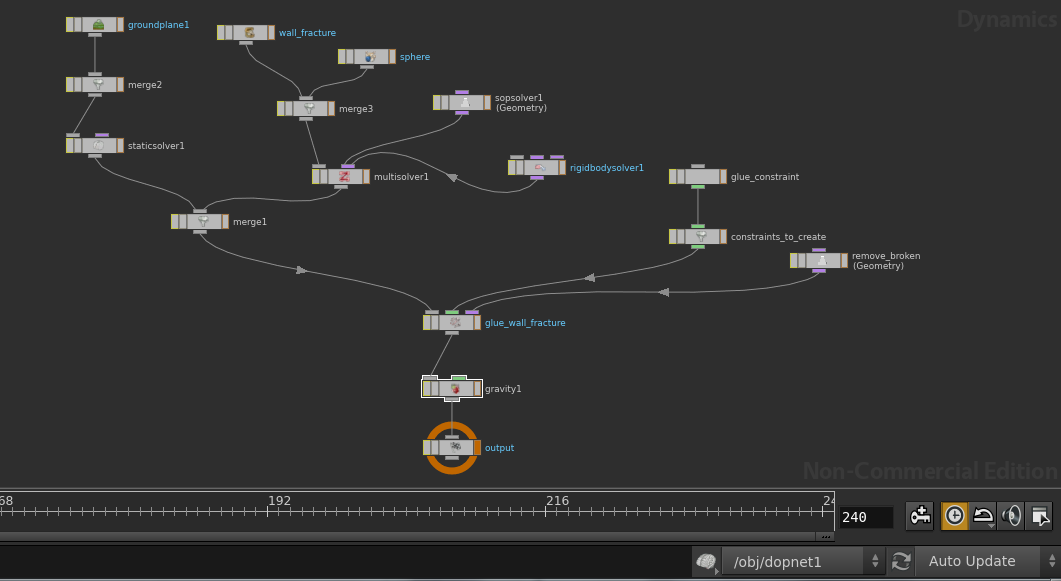

timfagan Posted August 3, 2015 Share Posted August 3, 2015 (edited) I think a cleaner way to set active object though is within the dop network. The second image shows the adjusted setup. The extra sop solver lets you define the active region with the help of the group and attribute wrangle, you just need to set the objects to initially be static. And just use an extra group node to get extra active regions. multiple _active_regions_edited2.hipnc Edited August 3, 2015 by kayman Quote Link to comment Share on other sites More sharing options...

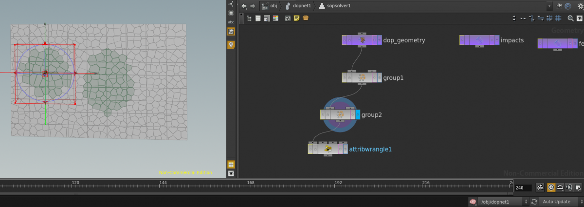

jakigui Posted August 3, 2015 Author Share Posted August 3, 2015 (edited) sorry it is not abt the dop netowrk it is abt da sop solver. I can c green part here but when i sim it is not correct. It doesnt take da active region. hip file i uploaded exactly like this. Edited August 3, 2015 by jakigui Quote Link to comment Share on other sites More sharing options...
timfagan Posted August 3, 2015 Share Posted August 3, 2015 (edited) You need to change the box object from active to static in the initial object type selector. Also helping you would be easier if you could take an extra moment to write a bit more clearly. Edited August 3, 2015 by kayman Quote Link to comment Share on other sites More sharing options...
jakigui Posted August 3, 2015 Author Share Posted August 3, 2015 Sorry. It worked Thanks a lot. Quote Link to comment Share on other sites More sharing options...
