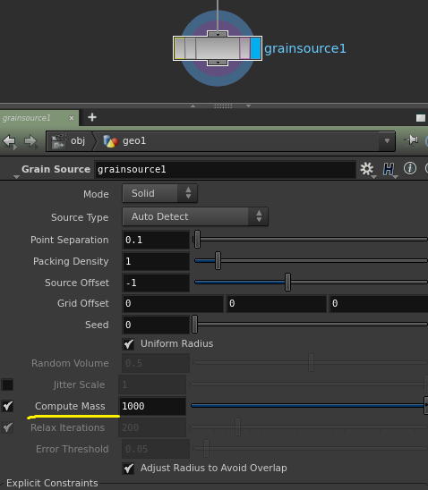

cwalrus Posted September 9, 2015 Share Posted September 9, 2015 Hi - I've got nice results with my WetSand - I'm just trying to increase the mass of the particles, and from searching it seems there is no built-in node for this? I tried POPProperty with no luck... Any suggestions? Thank you! Quote Link to comment Share on other sites More sharing options...
sultan Posted September 10, 2015 Share Posted September 10, 2015 (edited) Hi cwalrus did you use 'ComputeMass' option in GrainSource node ? And then in your Forces you can turn OFF 'IgnoreMass' option. Edited September 10, 2015 by sultan 1 Quote Link to comment Share on other sites More sharing options...
cwalrus Posted September 10, 2015 Author Share Posted September 10, 2015 AHA! thank you - couldn't find that anywhere! Quote Link to comment Share on other sites More sharing options...
