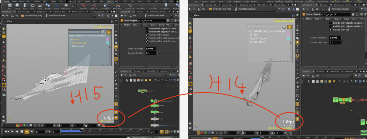

Guest tar Posted November 27, 2015 Share Posted November 27, 2015 I have a test flag that computes 5 to ~10 times faster - from ~2fps to 10 or 18 fps. I'm yet fully verify that it computes a similar output as the collision has some new options. Quote Link to comment Share on other sites More sharing options...
Erlich Bachman Posted November 28, 2015 Author Share Posted November 28, 2015 (edited) Since that is a test flag, can you post the scene? I'v done a lot of tests in h14 (in h15 not that much), and maybe your file will show what parameters are significant in h15, but have weak effect on speed in h14. Edited November 28, 2015 by Erlich Bachman Quote Link to comment Share on other sites More sharing options...
Guest tar Posted November 28, 2015 Share Posted November 28, 2015 Attached! Test is H15.0.301 & H14.0.474 Dual 3.33MHz 6 cores, OsX 10.10.5 PirateFlag2bOD.hipnc Quote Link to comment Share on other sites More sharing options...
Jason Posted November 28, 2015 Share Posted November 28, 2015 Also, be sure to update to the latest daily build. They recently had a bug that affected performance badly... You can see the entry referring to it in the journal from a few days ago. Quote Link to comment Share on other sites More sharing options...
Erlich Bachman Posted November 28, 2015 Author Share Posted November 28, 2015 (edited) Thanks, Marty! The lowest fps for h14 on my system is 2,6 and H15 lowest - 21. But average for entire scene : 9 and 25 correspondingly. So legit ~3x speed up here ) But h15 sim really messed up. Its like some strings pulling a rubber, not a wind. In h14 its more like wind and cloth.Maybe Jason is right, I should try latest build ) Edited November 28, 2015 by Erlich Bachman Quote Link to comment Share on other sites More sharing options...
Guest tar Posted November 28, 2015 Share Posted November 28, 2015 Great! Yep - also try to rebuild it in h15 - it drops to from 18fps to 10fps in my quick test, so I'm yet to decide if the settings are optimal in H15 or H14 and what is the real answer. Quote Link to comment Share on other sites More sharing options...
