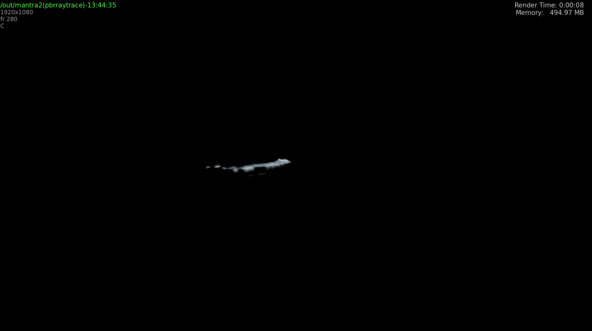

cwalrus Posted February 25, 2016 Share Posted February 25, 2016 Hi guys - If I render to Mplay, and then export the sequence to exr it looks different than exporting it to tif... even if both are 32 bit. What gives here? Anyone know? And which one is 'correct, ' so to speak? -Dr. Confused By This Quote Link to comment Share on other sites More sharing options...
Guest tar Posted February 25, 2016 Share Posted February 25, 2016 it should be that tiff is sRGB colourspace and exr is linear - though some examples would help identify the correct issue. https://www.sidefx.com/docs/houdini13.0/render/linear Quote Link to comment Share on other sites More sharing options...

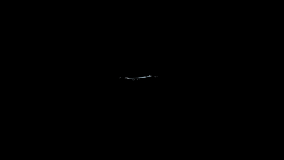

cwalrus Posted February 25, 2016 Author Share Posted February 25, 2016 Yeah that's probably it - turns out I can make the tif and the exr look the same by unchecking "convert to image format's colorspace" on the export dialog. However, neither looks exactly like the image in Mplay - check it out: versus the Tif (which looks just like the exr) Quote Link to comment Share on other sites More sharing options...
