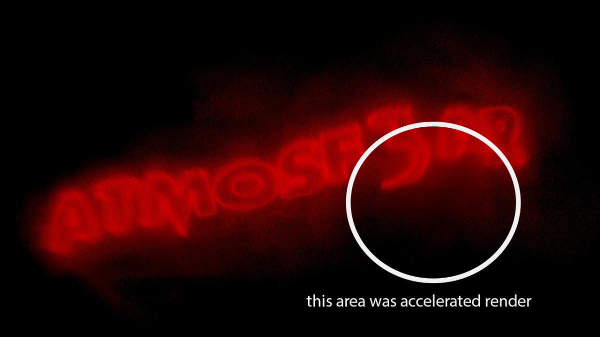

5dn Posted March 31, 2016 Share Posted March 31, 2016 Dear Forumers, I have a geometric light within a cloud that I am trying to render, but the edge of the render tiles do not match up quite right. I'm not sure how to fix this in the mantra settings. Any pointers? Thanks, 5DN Quote Link to comment Share on other sites More sharing options...
Fabiano Berlim Posted March 31, 2016 Share Posted March 31, 2016 Is that a IPR render? The sampling in IPR (render view with preview ON) doesn't match between tiles.if is the case. Try to turn off preview or render from mantra node. Quote Link to comment Share on other sites More sharing options...
5dn Posted March 31, 2016 Author Share Posted March 31, 2016 thanks. didn't realise that was an issue. sorted, ta. Quote Link to comment Share on other sites More sharing options...
