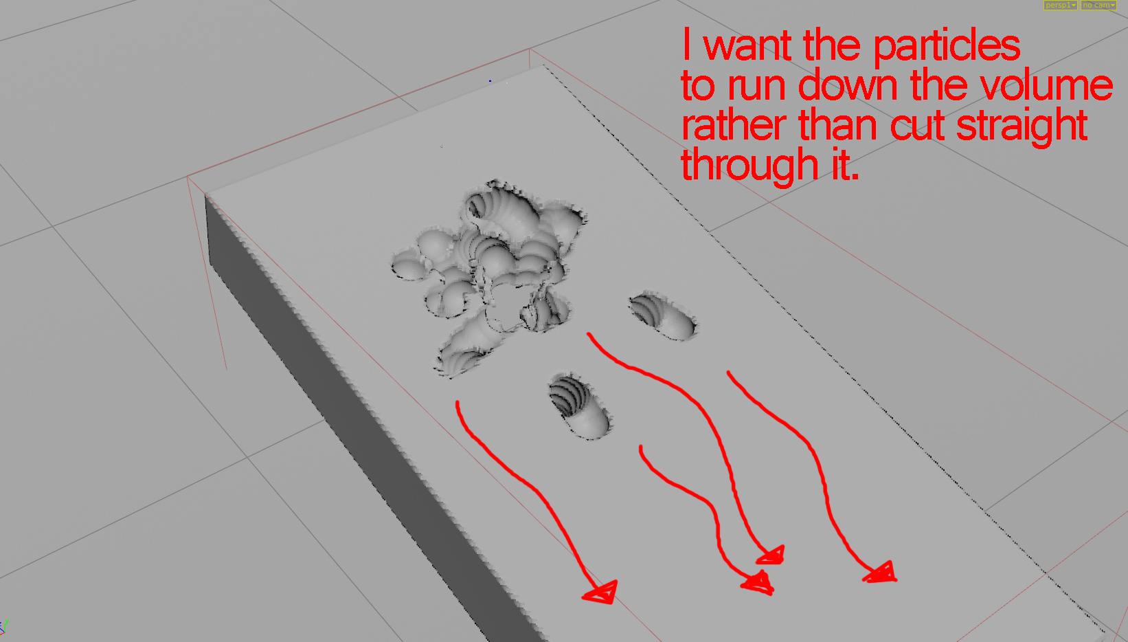

rich_lord Posted June 25, 2016 Share Posted June 25, 2016 (edited) I'm trying to set up an erosion effect using vdbs. I've found a few example files and have managed to set up the effect. It uses a vdb combine in a sop solver. This cuts away the surface and updates the collision of the vdb. However, I'm not getting any run-off. The particles just cut straight through the vdb and make holes. I don't know what to change to stop the particles doing this and make them flow down the surface. I can achieve this effect with polys, by pushing the geo along its normal, but id like to get it to work with VDBs also. Any idea what I need to do to make my setup work better? Thanks! erode.hip Edited June 25, 2016 by rich_lord Quote Link to comment Share on other sites More sharing options...
BRZ32 Posted June 27, 2016 Share Posted June 27, 2016 The normal you're looking for is called the volume gradient. https://www.sidefx.com/docs/houdini14.0/nodes/vop/volumegradient If you calculate the volume gradient each frame you should be able to do exactly the same thing you did with the poly version. 1 Quote Link to comment Share on other sites More sharing options...
rich_lord Posted June 28, 2016 Author Share Posted June 28, 2016 Thanks BRZ32. Yeah, I could grab that and use it as a force. I was hoping the particles would automatically run down the surface, like they do before I start eroding it. Alot more points with much smaller diameters worked a little better. I'll keep experimenting! Quote Link to comment Share on other sites More sharing options...
BRZ32 Posted June 28, 2016 Share Posted June 28, 2016 The solver you have going is exactly right but there isn't a force strong enough pushing them along the surface to keep it from just sinking. if you used the cross product of that gradient, it would be a force pushing along the surface rather than just away from it. Quote Link to comment Share on other sites More sharing options...
TheDude Posted June 28, 2016 Share Posted June 28, 2016 I haven't looked at your hip, but if you want 0 resistance to make the particles flow then you could try using a projected path erosion from the particles velocity Quote Link to comment Share on other sites More sharing options...
